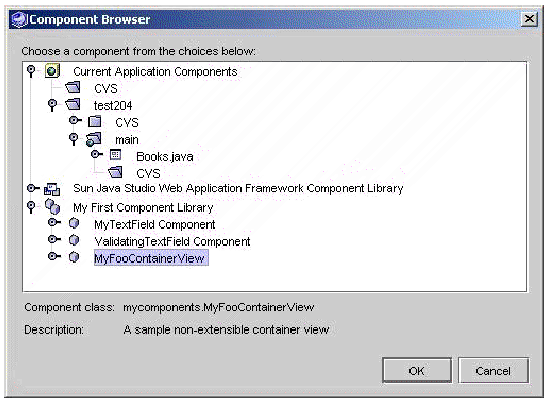

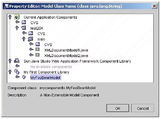

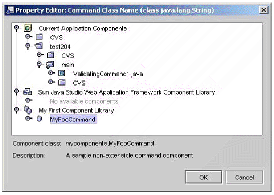

After non-extensible Model, Command, and ContainerView components have been distributed in a Web Application Framework component library, how do application developer's make use of the components?
The non-extensible Model, Command, and ContainerView components within a given Web Application Framework component library will appear in the IDE toolset in exactly the same IDE contexts that the current application's non-extensible components appear. If this sounds tautological, it is intentionally so. Its points out that from the Web Application Framework IDE toolset's perspective all Model, View and Command objects are components. As far as the IDE toolset is concerned, it does not matter whether it discovers the components in a component library JAR or within the current application space.
The images below will demonstrate this point by showing that the various component choosers within the IDE toolset allow the application developer to choose freely and transparently between library supplied non-extensible components and application defined non-extensible components.
