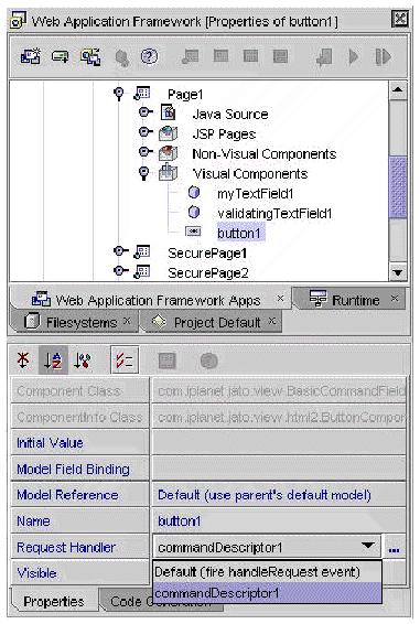

Technically speaking, the Non-Visual Components, which are visible as a sub-node of a ContainerView, are just a special case of the IDE toolset exposing ConfigurableBeans as nodes.

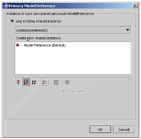

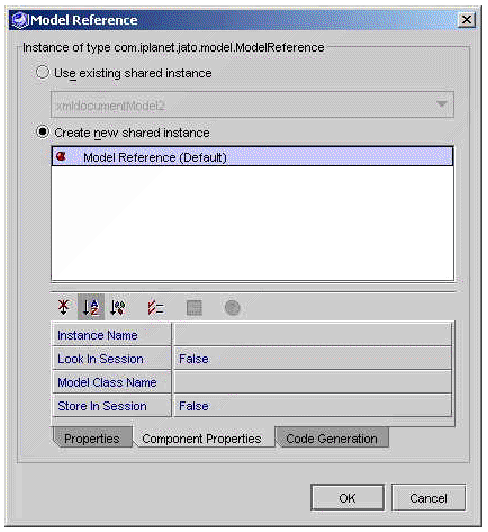

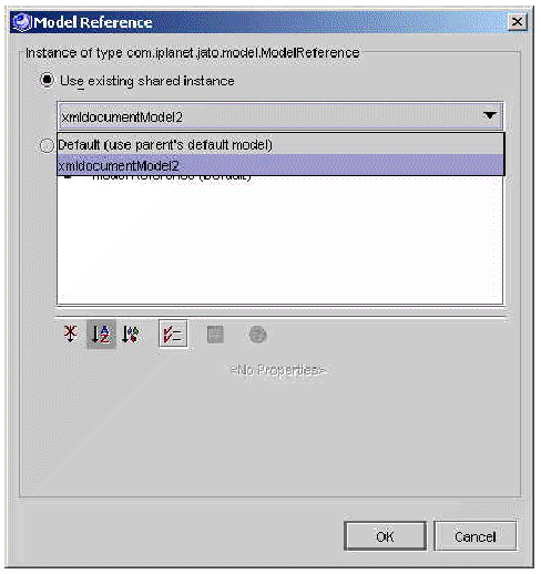

The IDE toolset uses a lookup algorithm to determine if the configuration property type corresponds to a registered ConfigurableBean type, and if so, it automatically invokes one of two special ConfigurableBean editors. These special Web Application Framework ConfigurableBean editors are shown below.
The IDE toolset will invoke one of the two editors above based on a further subtlety in the ConfigPropertyDescriptor, known as the value policy. The details of value policy are beyond the scope of this section, for more information see ConfigPropDescriptors API - Value Policy.
For this section, it is sufficient to observe that while their layout is radically different, both of the ConfigurableBean editors provide a common core functionality. Both of these editors provide the application developer with a dynamic list of ConfigurableBean types which are assignable from the configuration property type. That is the key value add of the ConfigurableBean component. It is this mechanism which allows the IDE to seamlessly and dynamically incorporate new choices into properties that otherwise would normally be severely restricted.

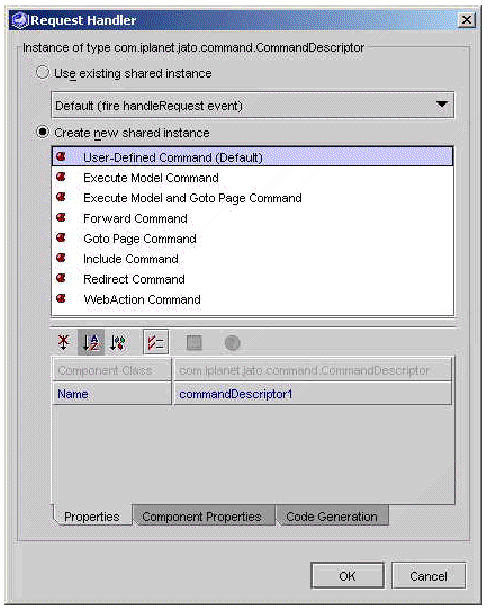

For instance, the IDE will enable the editing of a configuration property of type CommandDescriptor with the ConfigurableBean editor that displays a dynamic list of CommandDescriptor sub-types. The application developer first selects the type of CommandDescriptor from the list, and then configures an instance of that type. The properties of the selected sub-type, of course, are dynamically exposed via conventional JavaBean logic.

Additionally, the Web Application Framework offers other Command component opportunities. To understand this opportunity, it is necessary for the component author to fully understand the formal role of CommandDescriptors. Effectively, CommandDescriptors are configurable beans that allow for the design-time configuration of Command object instances.
The Web Application Framework and the IDE toolset utilize CommandDescriptors to allow the application developer to configure the usage of Command objects. That is to say, there is a formal uses relationship between CommandFields and Command objects and this relationship is mediated by CommandDescriptors. CommandFields are Views (for example, Buttons and HREFs) which invoke Command objects when activated. The application developer specifies which Command object will be invoked when the CommandField is activated via the field's Command Descriptor property.
A CommandDescriptor is a Web Application Framework object that encodes the information needed at run-time to construct a particular instance of a Command class and invoke it. Minimally, the CommandDescriptor specifies which Command class should be instantiated at run-time. The CommandDescriptor also allows developers to specify Command specific parameterized values. For instance, it is very common for a single Command object to be associated with multiple CommandFields. Each CommandField would employ a distinctly configured CommandDescriptor to direct and influence the execution of the Command. For more detailed information on this subject, see the Web Application Framework Developer's Guide.
Given the role of the CommandDescriptor, the opportunity exists for component authors to create a very rich Command component story through the combination of non-extensible Command components and component specific CommandDescriptor classes.
For instance, a component author can create and distribute a non-extensible Command component plus a custom CommandDesciptor class designed to allow developers to visually configure the invocation of the non-extensible Command component. The custom CommandDescriptor, itself, can be distributed as a ConfigurableBean component. ConfigurableBeans are visually exposed by the IDE toolset as Non-Visual Components.
