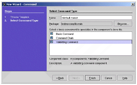

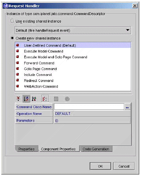

2. Create a new Command object.
Note - If you have not done this before, complete the Web Application Framework Tutorial).
The "New Command" wizard should now look as follows:
This figure shows the Select Command Type panel of the New Command wizard.
3. Select "Validating Command" from the component list, and complete the wizard.
4. Take the default settings and let the wizard create ValidatingCommand1 for you.
After the wizard completes, you can see that the IDE toolset has created a new class based on the component supplied template.

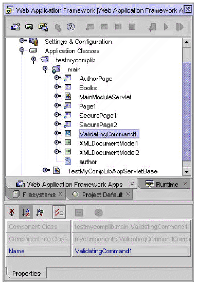

You application should now contain a ValidatingCommand1 object.
This figure shows the ValidatingCommand1 object node in the Explorer.

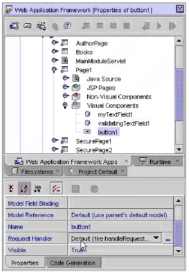

a. Select its Visual Components sub-node.
b. Select the node for button1 (below).
This figure shows the Properties of the button1 node in the Explorer.

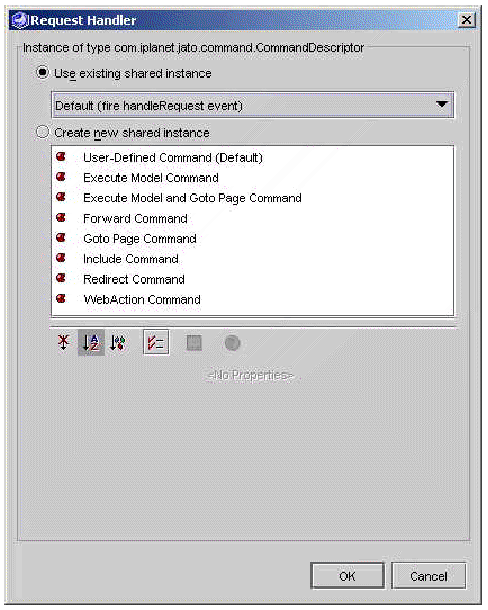

6. Edit button1's Request Handler property.
a. Click the property's ellipsis to bring up the full blown Command Descriptor Property Editor.
This is a very sophisticated editor and takes some effort to get familiar with it, but the payoff is substantial, as it offers exciting additional opportunities to component authors, which is discussed later.
First you must become comfortable using the editor. The Command Descriptor Property Editor contains a dynamic list of available CommandDescriptor types and it also contains an embedded property sheet (at the bottom of the editor) which will dynamically display the properties for the type of CommandDescriptor that is selected (this will become more clear in subsequent steps).
This figure shows the Command Descriptor Property Editor.
7. Select the Create new shared instance radio button.
Note - The meaning of "shared instance" is explained a few steps later.
8. Select the "User-Defined Command (Default)" item from the list of available descriptor types (see graphic above).
As you select a given command descriptor type, the bottom section of the editor displays the properties which are particular to the type of descriptor you selected.
Your property editor should look as follows:
This figure shows the properties in the Command Descriptor Property Editor that pertain to the type of descriptor you selected.

9. Select the Component Properties tab.
10. Within the Component Properties tab, select the Command Class Name property (shown below).
This figure shows the Command Class Name property selected within the Component Properties tab.

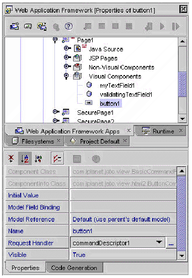

Before further configuration, spend a moment to fully understand the impact of the previous configuration on the Page1.
Note that the value of button1's Request Handler property now reads "commandDescriptor1" (shown below).
This figure shows the value of button 1's Request Handler property that now reads commandDescriptor1.

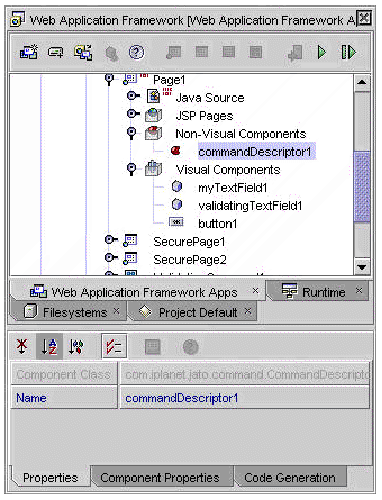

15. Expand the Page1's Non-Visual Components node (shown below).
There you will find a new non-visual component node "commandDescriptor1". It is the CommandDescriptor object you configured just moments ago. It is a CommandDescriptor that you configured as a "shared instance".
To visually express its "shared" nature, the IDE toolset provides the "Non-visual Components" node to house all of these shared instances.
This figure shows the Non-Visual Components Explorer node with commandDescriptor1's property sheet. .
The "Non-Visual Components" node is an Web Application Framework component model construct. It provides a ContainerView scoped space for the configuration of JavaBean objects (for example, Configured Beans) which are referenceable by properties elsewhere in the current ContainerView.
In this example, "commandDescriptor1" is a configured CommandDescriptor (which is a JavaBean), which is referenced by button1's Request Handler property. The key to this component model feature is that the same configured non-visual component can be referenced by more than one property within the current ContainerView scope (for example, more than one button or HREF could have its CommandDescriptor property also set to refer to commandDescriptor1).
A quick glance at the IDE toolset generated Java code for Page1 would reveal how this is expressed in Java terms. The benefits to both component authors and application developers are substantial. As a further clarification, not only can multiple CommandFields (for example, Buttons, HREFs, and so on) share commandDescriptor1 by each referring to it in their specific "Command Descriptor" property, but any property within the current ContainerView whose type is assignable from com.iplanet.jato.command.CommandDescriptor may be set to refer to commandDescriptor1. In essence, the non-visual components are class scoped, IDE configurable JavaBean objects which might be referenced in a type safe manner by any number of other visual components within the class.

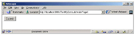

Test run Page1
The contents of Page1.jsp should show up in the browser.

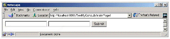

17. Enter an invalid value (any non-integer) in the ValidatingTextField text input, and submit the page.
The page should immediately redisplay with the text of the "Validation Error Message" property immediately following the ValidatingTextField.
This figure shows the Validation Error Message property in a browser.
