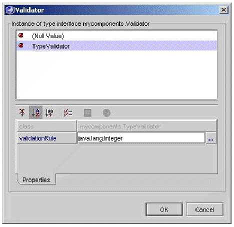

Design hint: The rudimentary implementation of TypeValidator above exposes the ValidationRule as a simple String property. In the absence of any further work, the IDE toolset will expose this property for editing with the default String editor. This will require application developers to explicitly set the value of the property to "java.lang.String" or "java.lang.Integer" or "java.lang.Float". That is not a very user friendly user interface. Since this ValidationRule falls into the ConfigurableBean category, the component author can make use of the full JavaBean component model to improve the user experience. Ideally, a component author would also design and deploy a custom property editor for this property. In this case, a simple drop down list property editor would be a big improvement over the default String editor. Then the component author can create a TypeValidatorBeanInfo which would specify the custom property editor of his choice. For more on this topic, see Design Actions.

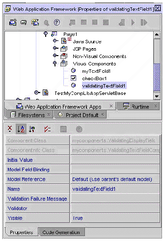

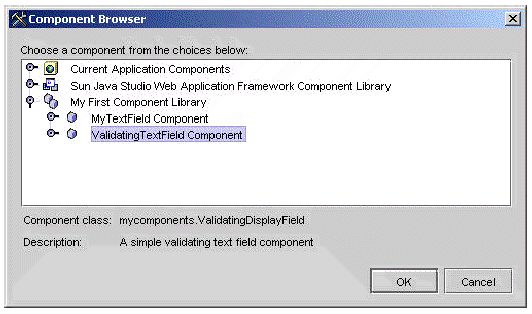

4. Implement the getComponentDescriptor() method to provide the basic design-time description of the component.
5. Implement the getConfigPropertyDescriptors() method to identify which properties you wish to expose in the IDE.
6. Implement the getJspTagDescriptors() method to specify the JSP tag which you want the IDE toolset to automatically add to associated JSP(s) whenever an instance of this component is added to a ViewBeans/ContainerViews.

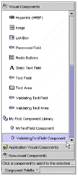

3. Add an instance of the ValidatingTextFieldComponent to Page1.
You can either select the component from the Component Palette, or select the Page1's Visual Components sub-node, right-click, and select the Add Visual Component... action from the pop-up menu.
This figure shows the Component Palette and the contents of the Visual Components tab.       This figure shows the Component Browser (an alternative to the Component Palette).
4. Select the "ValidatingTextField Component" from the list.
Observe how a child view named "validatingTextField1" is added to the page.
5. Select the validatingTextField1 visual component node.
Observe how the IDE's property sheet now displays the custom Validator and Validation Failure Message properties, in addition to the inherited TextField component properties.
This figure shows the validatingTextField1 visual component node and its property sheet (Properties tab).

7. Edit the Validator property.
This should bring up the following dedicated ConfigurableBean editor. For test purposes, set the validationRule property to "java.lang.Integer".
Make sure you specify the fully qualified class name for the validationRule property. Just "Integer" will not evaluate properly at run-time. It must be fully qualified, as in "java.lang.Integer".
This figure shows the dedicated ConfigurableBean editor.

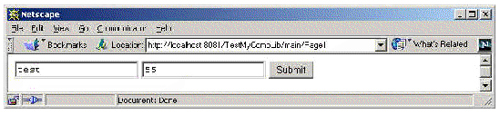

11. Test run Page1.
See the Web Application Framework Tutorial if you do not already know how to test run a Web Application Framework ViewBean.
The Page1 output should appear in a browser looking as follows (it now contains two text fields, one instance of MyTextField, and one instance of ValidatingTextField):
This figure shows the Page 1 output in a browser.

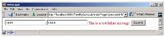

12. Enter an invalid value (for example, any value other than an integer) in the ValidatingTextField's text input, and submit the page.
The page should immediately be redisplayed with the text of the Validation Error Message property immediately following the ValidatingTextField.
This figure shows the Page 1 output redisplayed with the text of the Validation Error Message property.

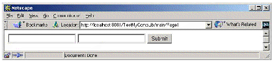

13. Enter a valid value (for example, 55, or any other valid integer) and submit the page.
The page should be redisplayed without the Validation Error Message text.
If you continue to get the Validation Error Message, go back and verify that you set the value of validatingTextField1's Validator->ValidationRule property to "java.lang.Integer", and not just "Integer".
This figure shows the Page 1 output redisplayed without the Validation Error Message text.

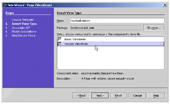

2. Create a new ViewBean object.
The new ViewBean wizard should now look as follows:
This figure shows the Select View Type panel of the new ViewBean wizard.
3. Select the "Secure ViewBean" from the component list and complete the wizard.
Take the default settings and let the wizard create SecurePage1 for you. (You can select Finish in the wizard stage shown above.)

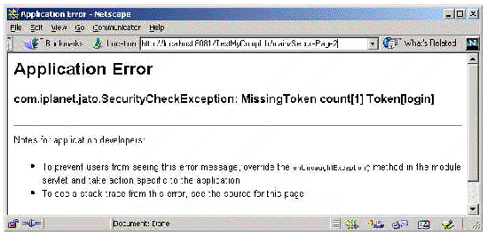

10. Test run SecurePage2.
Instead of seeing SecurePage2.jsp's content, you should see the following message in the browser:
Note - If you see this message, it means that the SecureViewBean security model has worked as intended. At least the access prevention has worked.

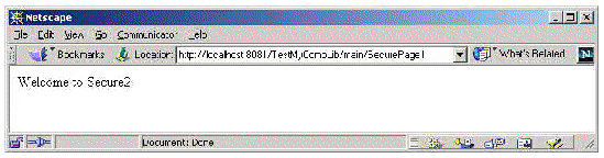

12. Test run the page flow from SecurePage1 to SecurePage2.
a. Test run SecurePage1.
b. Secure1 should appear in the browser as a blank page with a single button labeled "Submit".
The user should now have been granted the "login" token.
c. Press the Submit button.
This will trigger the handleButton1Request logic which will forward the request to SecurePage2.
The contents of SecurePage2.jsp should show up in the browser (because the user had accumulated the required tokens).
This figure shows the contents of SecurePage2.jsp in a browser.

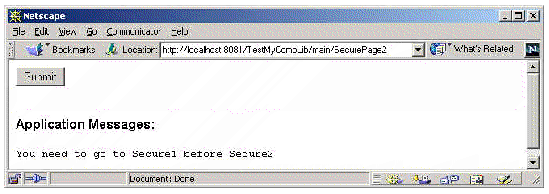

Not yet. First test the EventHandlerDescriptor feature (handleMissingTokens).
Recall that the SecureViewBeanComponentInfo declares an EventHandlerDescriptor which described an event handler called handleMissingTokens. Now you need to test this feature.
1. Select the SecurePage2 node.
2. Right-click, and select the pop up menu's Events->handleMissingTokens option.
This should insert the handleMissingTokens method skeleton into SecurePage2.java and automatically position the Java editor at that method.
3. Edit that method to automatically route users back to SecurePage1 when this event is triggered.
This is just an arbitrary means of testing the event handler. Application developers can implement this handler any way they want.
public void handleMissingTokens(MissingTokensEvent e)throws SecurityCheckException {
// Route invalid access users to SecurePage1
appMessage("You need to go to Secure1 before Secure2");
getViewBean(SecurePage1.class).forwardTo(getRequestContext());
// Stop further processing of the original request.
throw new CompleteRequestException();
4. Test run SecurePage2 again.
This time, the browser should return SecurePage1, because the event handler took control.
