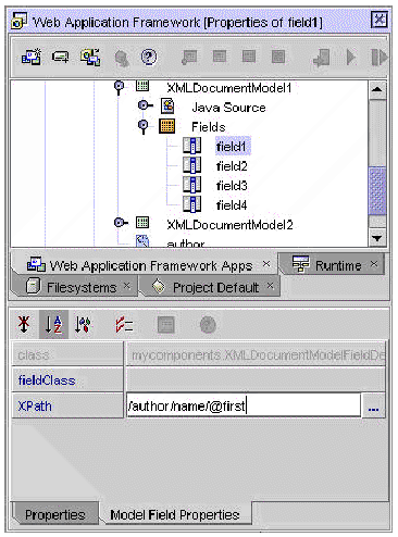

Create the ModelFieldDescriptor Class
The Web Application Framework component model provides extensible Model component authors with the opportunity to specify an arbitrary implementation of the com.iplanet.jato.model.ModelFieldDescriptor interface. This is a very minimal interface. Each implementation of ModelFieldDescriptor must also be a JavaBean. Model component authors should design a ModelFieldDescriptor as a bean that can be configured by application developers to define a model field at design-time. Component authors, therefore have tremendous freedom to design model fields which can expose all the design-time configuration opportunity they want, as long as it can be expressed as a JavaBean.
In the example, your model field design-time configuration needs are trivial. The application developer needs to be able to configure each model field with an XPath expression.
1. In any Java editor, create the class mycomponents.XMLDocumentModelFieldDescriptor.
2. Implement the basic com.iplanet.jato.model.ModelFieldDescriptor interface.
3. Add a get and set method for the property XPath.
4. Add a get and set method for the property FieldClass.
This is an optional property. If populated, at run-time the Model will coerce the raw value retrieved with the XPath expression into the type specified by the FieldClass property.

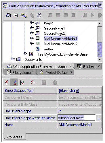

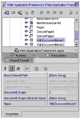

5. Add a get and set method for the property named "DocumentScope".
6. Add a get and set method for the property named "DocumentScopeAttributeName".
7. Add a get and set method for the property named "CurrentDatasetName".
This property will get a more user friendly display name "Base Dataset Path", but that work will be done in the XMLDocumentModelComponentInfo.

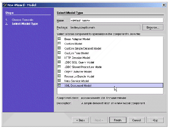

2. Create a new Model object.
If you have not done this before, complete the Web Application Framework Tutorial.
The new Model wizard should now look as follows:
Note - Depending upon the version of Web Application Framework, you might not see all of the models that are shown next. The important point is that you see the entry for "XML Document Model".
This figure shows the Select Model Type panel of the New Model wizard.
3. Select the "XML Document Model" from the component list and complete the wizard.
Take the default settings and let the wizard create "XMLDocumentModel1" for you.
After the wizard completes, you can see that the IDE toolset has created a new class based on the component supplied template.
4. To test your mode fully, create a second XML Document Model.
Your application should now contain two XML Document Models (XMLDocumentModel1 and XMLDocumentModel2).
Note the Base Dataset Name, Document Scope, and Document Scope Attribute Name properties.
This figure shows the two XML Document Models that were just created: XMLDocumentModel1 and XMLDocumentModel2.
Note above that the Document Scope property value is the raw integer 2. This is because XMLDocumentModelComponentInfo declared the DocumentScope property thus. The type is Integer.Type, and the default value is javax.servlet.jsp.PageContext.REQUEST_SCOPE. The net effect in the IDE will use the default Integer property editor which will express the raw integer value, in this case 2.

a. Select the XMLDocumentModel1 node.
b. Edit its Document Scope Attribute Name property.
Set the value to "authorDocument".
c. Leave the Document Scope and the Base Dataset Path properties unchanged.
This figure shows the XMLDocumentModel1 node and its property sheet with the Document Scope Attribute Name field set to authorDocument.

h. Select the field1 node.
Select the Model Field Properties tab on its property sheet.
i. Edit field1's XPath property.
Set the value to the XPath expression "/author/name/@first".
This figure shows the XMLDocumentModel1 Explorer node, with the Fields node expanded and the property sheet of the Field1 node.
j. Repeat the previous step, and adjust the XPath property for the remaining three fields as follows:

a. Select the XMLDocumentModel2 node.
c. Edit its Base Dataset Path property.
Set the value to the XPath expression "/author/works/book".
That is an XPath expression that will address the collection of book entries (for example, a Web Application Framework dataset).
d. Leave the Document Scope property unchanged.
This figure shows the XMLDocumentModel2 node and its property sheet.

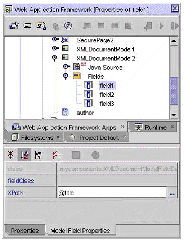

g. Right-click, and select the pop up menu's Add Field ... action to add "field1", "field2", and "field3".
h. Edit each field's XPath property to XPath expressions relative to the value of the Base Dataset Path property set above.
This figure shows the XMLDocumentModel2 field nodes and the Model Field Properties tab of field1.

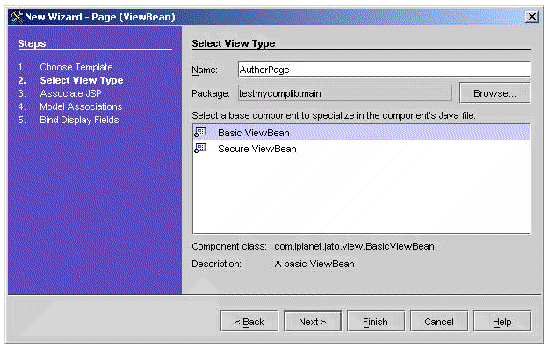

7. Create the AuthorPage
a. Invoke the "New View" wizard.
This figure shows the Select View Type panel of the New ViewBean wizard.
b. Take the default values in the Associate JSP panel, and press Next.

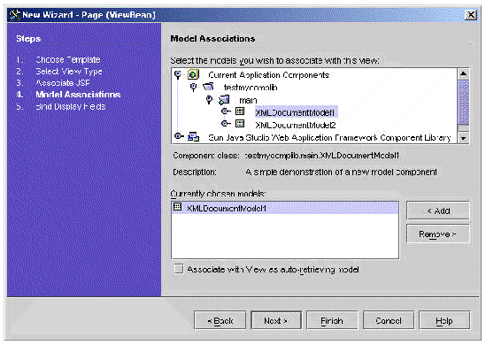

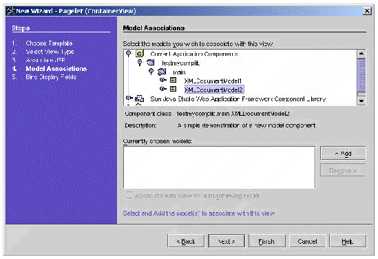

c. In the Model Associations panel (shown in the next figure), expand the Current Application Components node until you find "XMLDocumentModel1".
That will cause the "XMLDocumentModel1' to appear in the Currently chosen models section of the panel.
This figure shows the Model Associations panel of the New ViewBean wizard.

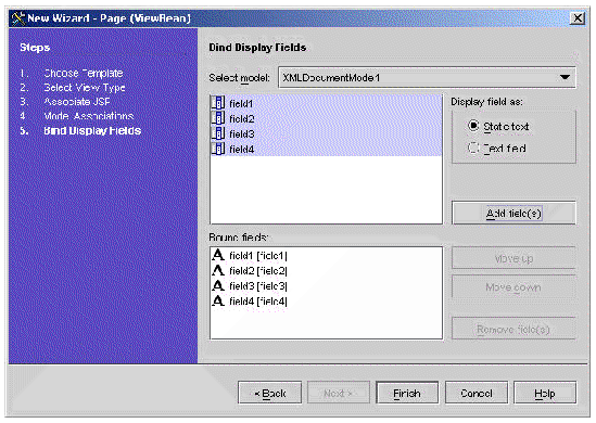

d. In the Bind Display Fields panel (shown in the next figure), select all four of the Model fields that are available, and press the Add Fields button.
That will cause four entries to appear in the Bound Fields section of the panel.
e. Press Finish.
This figure shows the Bind Display Fields panel of the New ViewBean wizard.

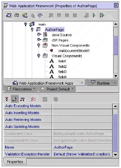

After completing the wizard in the manner described above, you should find that the AuthorPage node looks like this.
The individual child display fields should be properly bound to the corresponding XMLDocumentModel1 fields.
This figure shows the AuthorPage Explorer node and its property sheet.

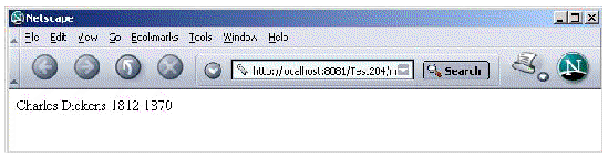

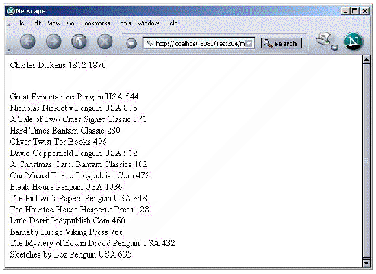

9. Compile all the classes in the application and test run the AuthorPage.
The author's data should appear in the browser as follows:
This figure shows the author's data in the browser.

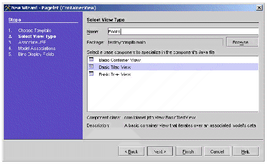

b. In the Select View Type panel (shown in the next figure) select the "Basic Tiled View" component.
c. Explicitly set the Name to be "Books".
d. Press Next.
This figure shows the Select View Type panel of the New ContainerView wizard.
That will cause the "XMLDocumentModel2' to appear in the Currently chosen models section of the panel.
This figure shows the Model Associations panel of the New ContainerView wizard.
That will cause three entries to appear in the Bound Fields section of the panel.

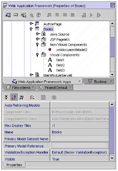

This figure shows the Books TiledView Explorer node and its property sheet.

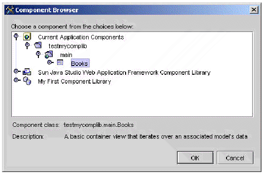

11. The TiledView requires one additional configuration step that you have not seen before in this guide.
You need to configure the :Book TiledView's Primary Model Reference property to reference "XMLDocumentModel2". If you do not configure this property, the test run of this TiledView will show no data. That is a common Web Application Framework application developer error.
Edit the Primary Model Reference property (shown next), and from its drop down list select the "xmldocumentModel2" value.
This figure shows the Primary Model Reference property in the property sheet for the Books Explorer node.
