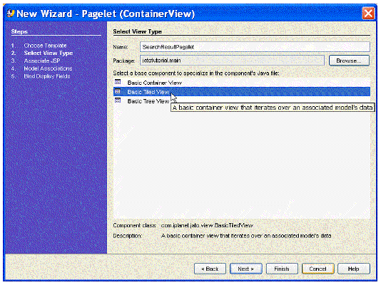

1. Select the main module, and click the Add Pagelet button on the Web Application Framework toolbar.
The Select View Type panel displays.
2. Enter SearchResultsPagelet in the Name field (to replace <default>).

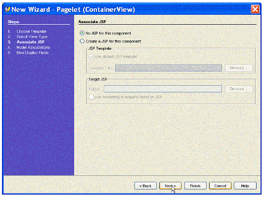

3. Select Basic Tiled View from the pagelet component type list.

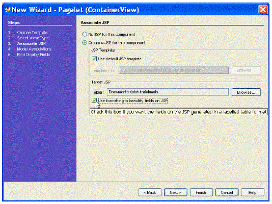

The Associate JSP panel displays.
A matching JSP is not be created for this pagelet component. This pagelet component's JSP tags and content will automatically be added directly to the parent page component's JSP page.
The question is whether to create a JSP for a pagelet component or not. There are pros and cons to both possibilities. The deciding factor is how the pagelet component will be reused on the JSP side. If the pagelet is meant to be rendered the same regardless of what page (or another pagelet) parents it, then you should create a JSP for the pagelet. This single JSP pagelet file will be included (JSP file include directive) in every parenting page and pagelet JSP that requires it. Therefore, any change made to the JSP pagelet file will be reflected wherever it was included.
However, if the pagelet requires the flexibility of being rendered in a different way for various parenting JSP pages and pagelets, the JSP pagelet content must be inlined and customized in each of its parenting JSP page or pagelet files.
The nuances of these techniques might not be clear to you right away, but do not be concerned. As you become more skilled with JSP pages and the Web Application Framework, you will begin to fully understand the flexibility and power of the reusability of the Web Application Framework page and pagelet components.
For more information, read the notes that are included on this wizard panel, and refer to the Web Application Framework Developer's Guide and the Web Application Framework Component Author's Guide.

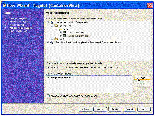

The Model Associations panel displays.

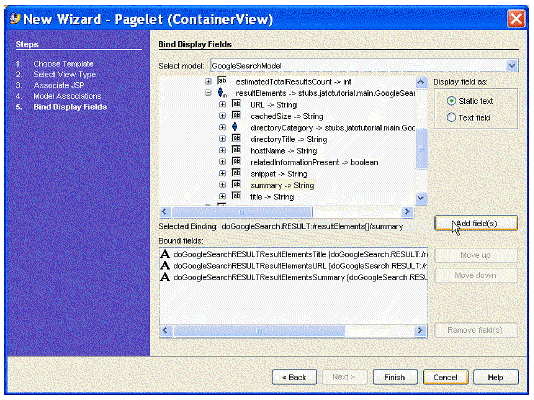

6. Expand Current Application Components to expose jatotutorial/main.
The Bind Display Fields panel displays.
10. Expand the doGoogleSearch node.
12. Expand the resultElements node.
13. Add the following three return parameters as Static text fields:

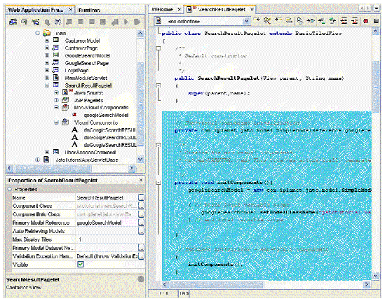

You have created the SearchResultsPagelet TiledView with three fields that are bound to some return parameters in the GoogleSearchModel.
15. Rename the fields to have shorter, simpler names.
The following table shows the longer field names in the left column, and the shorter names in the right column.

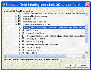

Currently, the Application Framework tools do not have a direct way to set this value by browsing the Web service, and selecting a key path. But there is a one-off Web service browsing technique for getting to this value so that you can copy it, then paste it into the property.

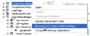

Start by selecting the GoogleSearchModel in your application.
1. Right click the model, and select Browse/Add Object Field Bindings.
The Web Service Field Bindings editor is launched.

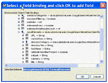

2. Navigate down the operation path where the fields in the TiledView are bound.
3. Select the parent node of the fields: resultElements
Notice the bold-faced Selected Dataset value at the bottom of this editor: doGoogleSearch.RESULT:/resultElements.
Although it does not appear to be selectable, you can use your mouse to click/drag select it.
4. Highlight it and press Ctrl-C to copy the value to the buffer.
5. You can now Cancel out of this editor.
Do not click OK, as doing so adds a field to your Web service model. Although there is no harm in this, you do not need the field.
6. Select the SearchResultsPagelet TiledView node, and paste the value into its Primary Model Dataset Name property.

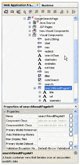

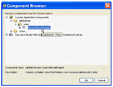

1. Expand the GoogleSearchPage node.
2. Right-click the GoogleSearchPage's Visual Components node, and select Add Visual Component.
This launches the Component Browser.
3. Expand the Current Application Components node.
6. Select the SearchResultsPagelet TiledView component.

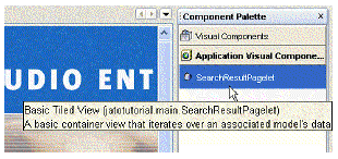

Note - The figure below shows an alternate way of adding pagelet component using the Component Palette. |
If you select the Application Visual Components section of the Component Palette Window you will see all the Pagelet components which have been created so far in the application. For instance, SearchResultPagelet is available. Steps 2-7 may be replaced by simple clicking with your left mouse button on SearchResultPagelet in the Component Palette.

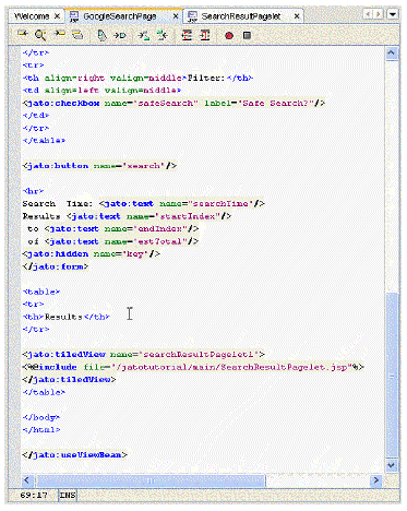

The SearchResultsPagelet TiledView is added as a visual component under the GoogleSearchPage just like the other visual components. Notice that the pagelet does not have a JSP itself. The pagelet and the other visual components that are contained by the pagelet will have tags added to the parenting page component's JSP page. A pagelet component can be reused by multiple page components, but this is a topic outside the scope of this tutorial.
Note - In Add a TiledView an alternate pagelet creation option was shown. In that case we did create an new JSP fragment to be the associated JSP for the new pagelet. If you used this alternative technique then the parenting page GoogleSearchPage will not add new tags for the added pagelent but instead will only add a JSP include directive for the pagelets JSP fragment. Logically the addition of the pagelet is the same for both techniques but the changes to the GoogleSearchPage JSP will be different due to the existence of the pagelet's associated JSP fragment. |
1. Open the JSP by double clicking the GoogleSearchPage JSP page node.
At the bottom of the JSP, the TiledView pagelet and contained display field tags have been inserted, but without any formatting.
You can add all the HTML markup you want, but the display field tags that belong to the SearchResultsPagelet TiledView must be nested inside of the jato:tiledView tags.

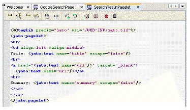

2. Feel free to be creative with the HTML formatting or use the following content to get you started.
A few things above need to be explained:
First, take a look at the escape attributes for the title and summary field tags. The default is true, which means escape all special characters. This means that any HTML markup that is returned in the value of this field will be visible to the end user. This Web service places bold tags (<b>) around any words that match the query string that was entered by the end user. So, by specifying escape=false, you are telling this tag that you want the markup to be rendered as HTML markup, not displayed to the end user. Experiment with this attribute by making one tag false and the other true to see the difference.
Second, notice that there are two occurrences of the tag that represents the url field. A simple copy/paste of the tag allows you to display the same dynamic data many times. In this case, the first instance of the tag will populate the href attribute of the anchor tag (<a href="...").
Notice also that the name attribute of this instance of the url field tag uses single quotes. This is because this tag is contained inside of double quotes for the href attribute value. Using double quotes nested inside of double quotes should render perfectly fine at runtime, but many HTML editors will indicate an error condition for this case. Using the single quotes inside the double quotes should remedy these situations.
The second instance of the url field's tag is used to display it as the link text to the user.
Everything between the two jato:tiledView tags will appear once per row of data that is returned (five times in this example).

1. Open the page's JSP by double clicking the GoogleSearchPage JSP page node. Open the pagelets JSP fragment by double clicking the SearchResultPagelet JSP fragment node. The images of the JSP source is shown below.
If you recall in Add a TiledView, when we created the SearchResultPagelet we not only provided for the creation of a JSP fragment to be associated with the new pagelet but also selected automatically formatting checkbox. See image above. Notice that the GoogleSearchPage has been automatically updated with HTML table tags and table header tags and the searchResultPagelet1 tileview has automatically been added including the directive for the pagelets JSP fragment. You may accept the auto-formatted changes as is or you may alter both JSP files as shown to make the search result look even better.
