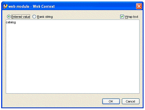

Setting the Web Context for the Web Module
When you deploy a J2EE application to a J2EE application server, URLs are mapped to the web resources in the web module. URLs are mapped by appending URL patterns to a URL path. For the Sun Java System Application Server, the URL path has this general form:
http://hostname:port/web-context/URL-pattern
The elements in this path are determined as follows:
In other words, the URL patterns that you assigned in the web module property sheet are relative to the web context that you assign in this procedure.
To set the web context, use the following procedure:
1. Right-click the included web module node (this web module node is under the J2EE application node) and choose Properties.
2. Click the Web Context ellipses (...) button and type the string you want to use.
FIGURE 4-2 shows the CatalogWebModule property sheet described in this scenario. The web context property is set to catalog.
FIGURE 4-2 Property Sheet for CatalogWebModule
Screenshot of Property sheet for the catalog web module. The Web Context field has the value catalog.
When the web context property is set to catalog, URLs for web resources in the CatalogApp J2EE application will have this general form:
http://hostname:port/catalog/URL-pattern
If you do not supply a web context, it defaults to blank. If you let the web context for CatalogApp J2EE application default to blank, the URLs for web resources in the application would have this general form:
http://hostname:port/URL-pattern

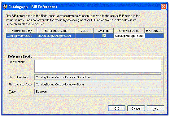

Linking the EJB Reference
CatalogWebModule contains JNDI lookup code and an EJB resource reference. The CatalogWebModule code and the deployment descriptor specify interfaces of type CatalogManagerBeanHome and CatalogManagerBean. For information on how the lookup code and the resource reference are set up, see The EJB Resource References.
The CatalogData EJB module contains remote interfaces of type CatalogManagerBeanHome and CatalogManagerBean and a bean class named CatalogManagerBeanBean that implements the interfaces. For information on creating the interfaces, see Creating Remote Interfaces for the Session Enterprise Bean.
Before executing the CatalogApp J2EE application, you must link the EJB reference in the web module to the enterprise bean in the EJB module.
In some circumstances, you link the reference on the web module's property sheet before creating the application. The reference in CatalogWebModule was not linked in the web module property sheet. In this scenario, the reference is linked on the CatalogApp property sheet.
To link an EJB reference on the application node property sheet, use the following procedure:
1. Right-click the application node and choose Properties. In the Properties section, click the EJB References ellipsis (...) button.
The EJB References property editor opens.
2. Check the status of the EJB references.
This editor shows you all of the references that have been declared in the application. The references are identified by module and reference name.
FIGURE 4-3 shows the EJB References property editor for the CatalogApp J2EE application. There is one EJB reference, which is declared in CatalogWebModule. The reference is named ejb/CatalogManagerBean, and it is not resolved.
FIGURE 4-3 Unlinked EJB Reference
Screenshot of the application node's EJB references property editor with an unlinked reference.[ D ]
If a reference is not resolved, the Value field is empty and the Error Status field displays an icon that represents an error.
3. Link any unresolved references.
Click the Override Value field. The field displays a list of the enterprise beans in the application that implement the interfaces that are specified in the reference. Select one of these enterprise beans.
FIGURE 4-4 shows the same EJB reference as FIGURE 4-3, but the reference has been linked with an override. When the application executes, the method calls coded in CatalogWebModule will call the enterprise bean specified in the Override Value field. In FIGURE 4-4, the Override Value field specifies an enterprise bean in the CatalogData EJB module, named CatalogBeans.CatalogManagerBean.
FIGURE 4-4 EJB Reference Linked by Override
When a reference is resolved, the Override Value field displays the name of the linked enterprise bean, and the Error Status field is empty.

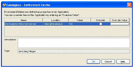

Overriding Environment Entries
If an application contains environment entries, you might need to override the values that were set for them on the module property sheets. You do this on the application's Environment Entries property editor.
To override an environment entry value, use the following procedure:
1. Right-click the application node and choose Properties. In the Properties section, click the Environment Entries ellipsis (...) button.
The Environment Entries property editor opens. This editor shows you all of the environment entries that have been declared in the application. The environment entries are identified by reference name and module.
2. Study the environment entries in the application.

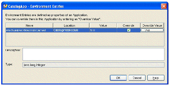

FIGURE 4-5 shows the Environment Entries property editor for the CatalogApp application. The property editor displays an environment entry that was declared in the web module. (To see how this environment entry was declared in the web module, see Setting Up Resource Environment Entry References.)
The Value field displays 100, which is the initial value that was set on the web module's property sheet.
FIGURE 4-5 J2EE Application Environment Entries Property Editor
Screenshot of J2EE application property sheet showing the initial value set in module property sheet.[ D ]
3. When the initial values are not appropriate for the assembled application, override them.
a. For the environment entry you are overriding, click the Override Value field and the ellipsis (...) button.
The Override Value dialog box opens.
b. In the Value field, type the override value. Click OK to close the dialog box and return to the property editor.
FIGURE 4-6 shows the Environment Entries property editor with a value in the override field.
