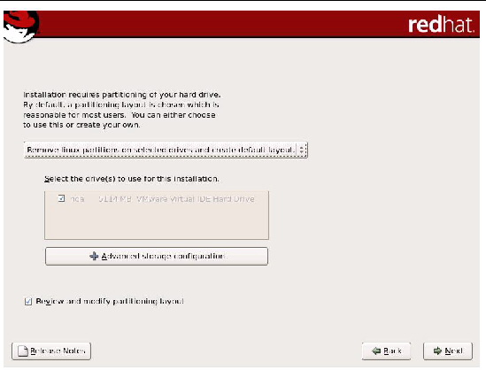

12. In the Disk Partition Setup screen, do the following:
a. Select the option for Remote Linux partition on selected drives and create default layout or manually partition the disk using the Create custom layout option of Disk Druid, then click Next.
b. Partition the disk as appropriate by referring to the instructions presented on the Red Hat disk partitioning screen.
