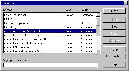

To Stop and Start the Server on Windows
The iPlanet Application Server is automatically installed as a Windows service. To stop, and start the sever, and to set service properties, follow these steps:
  1. From the Start menu, follow this path to open the Control Panel:
    Settings > Control Panel.
  2. Double click Services. You will see the screen shown in Figure 2- 1.
Figure 2-1    The Services Screen
  1. Highlight iPlanet Application Server 6.5 and click Startup.

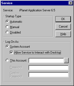

    You will see the screen shown in Figure 2-2.
Figure 2-2    The Service Parameters Screen
  1. Turn on the Allow Service to Interact with Desktop flag (see arrow 1), and click OK. This returns you to the Services screen (Figure 2 -1).
    (Though this step is unrelated to starting and stopping the server, it will be useful later to view the logs while the application is running.)
    Tip If you prefer to manually start the server instead of automatically starting it at system startup, you can also select the Manual option in the Startup Type box (see arrow 2 in Figure 2-2).

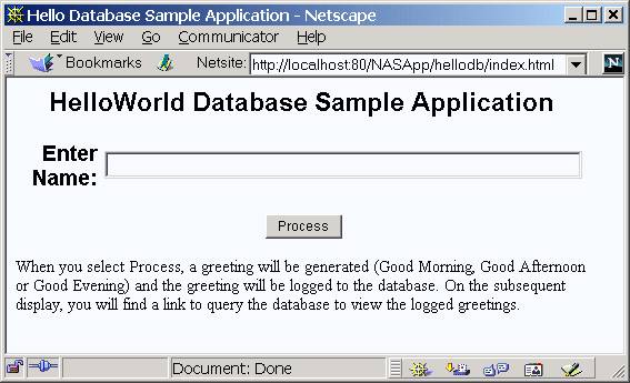

Enter the number of the network port used by your web server in place of the [PORT_NUMBER], and enter this URL:
http://127.0.0.1:[PORT_NUMBER]/NASApp/hellodb/index.html
You will see the screen shown in Figure 2 - 3.
Figure 2-3    HelloDB sample application
