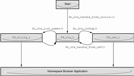

Figure 3-1 illustrates the XFN APIs that are used by the browser application.
Figure 3-1 Diagram of fnbrowse Program
Graphic
The first example is a browser that lists all names that it finds in the namespace. When the program is invoked, the browser is set at the initial context or the composite name given on the command line.
See "Commands" and "Sample Output".
