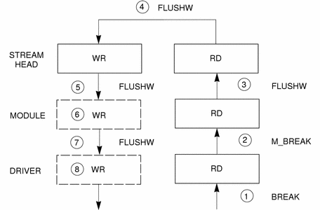

Figure 8-1 and Figure 8-2 further demonstrate flushing the entire Stream due to a line break. Figure 8-1 shows the flushing of the write-side of a Stream, and Figure 8-2 shows the flushing of the read-side of a Stream. In the figures dotted boxes indicate flushed queues.
The following takes place (dotted lines mean flushed queues):
A break is detected by a driver.
The driver generates an M_BREAK message and sends it upstream.
The module translates the M_BREAK into an M_FLUSH message with FLUSHW set and sends it upstream.
The Stream head does not flush the write queue (no messages are ever queued there).
The Stream head turns the message around (sends it down the write-side).
The module flushes its write queue.
The message is passed downstream.
The driver flushes its write queue and frees the message.

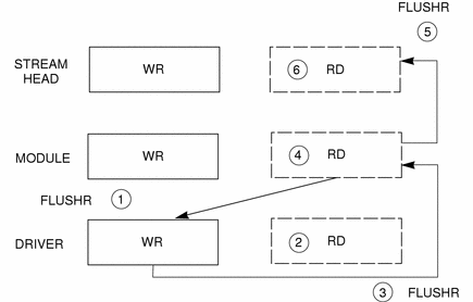

Figure 8-2 shows flushing read side of a Stream.
The events taking place are:
After generating the first M_FLUSH message, the module generates an M_FLUSH with FLUSHR set and sends it downstream.
The driver flushes its read queue.
The driver turns the message around (sends it up the read-side).
The module flushes its read queue.
The message is passed upstream.
The Stream head flushes the read queue and frees the message.

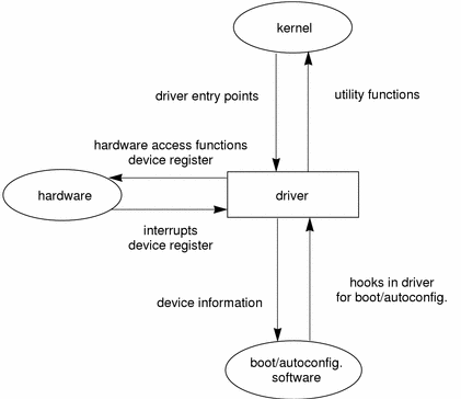

The set of STREAMS utilities available to drivers are listed in Appendix B, STREAMS Utilities. No system-defined macros that manipulate global kernel data or introduce structure-size dependencies are permitted in these utilities. So, some utilities that have been implemented as macros in the prior Solaris system releases are implemented as functions in the SunOS 5.x System. This does not preclude the existence of both macro and function versions of these utilities. It is intended that driver source code include a header file that picks up function declarations while the core operating system source includes a header file that defines the macros. With the DKI interface the following STREAMS utilities are implemented as C programming language functions: datamsg(9F), OTHERQ(9F), putnext(9F), RD(9F), and WR(9F).
Replacing macros such as RD with function equivalents in the driver source code allows driver objects to be insulated from changes in the data structures and their size, increasing the useful lifetime of driver source code and objects. Multithreaded drivers are also protected against changes in implementation-specific STREAMS synchronization.
The DKI defines an interface suitable for drivers and there is no need for drivers to access global kernel data structures directly. The kernel functions drv_getparm(9F) fetches information from these structures. This restriction has an important consequence. Since drivers are not permitted to access global kernel data structures directly, changes in the contents/offsets of information within these structures will not break objects.
