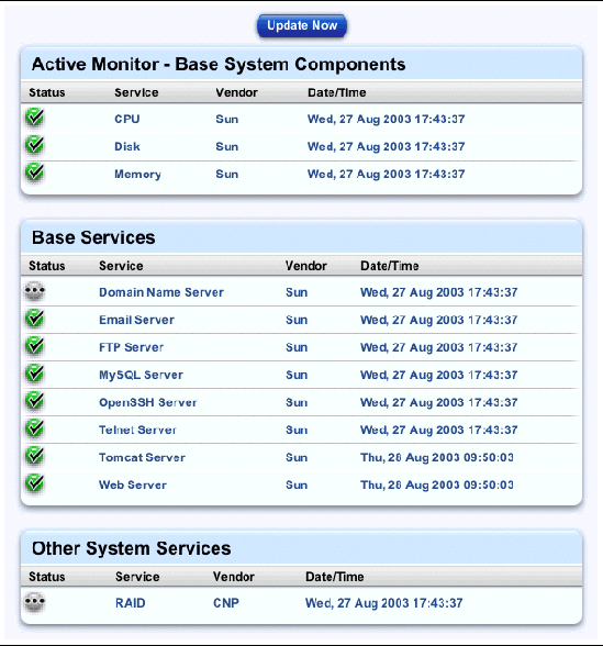

Active Monitoring Information
To view the Active Monitoring information for the server on which the Sun Control Station software is running:
1. Select Station Settings > Active Monitoring.
The Active Monitoring status tables appear; see FIGURE 2-1.
2. You can click Update Now above the tables to begin updating system and service status information immediately.
This may take as long as several minutes and proceeds in the background.
 FIGURE 2-1 Active Monitoring Status tables
This screenshot shows a sample of the Active Monitor Status tables, including Base System Components, Base Services and Other System Services.

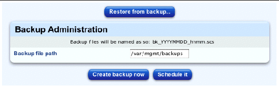

Creating a backup
To create a backup of the data on the Sun Control Station:
1. Select Station Settings > Backups.
The Backup Administration table appears; see FIGURE 2-3.
2. Enter a path in the field Backup File Path.
The default path is /var/mgmt/backups on the the local server.
We recommend that you not back up to the local server; you should back up to a different server.
You can mount an external filesystem to which to write the backup file (either a Windows File Sharing (SMB) server or Network File Sharing [NFS] server).
Note - You must have write permissions for this path.
3. Click Create Backup Now.
The Task Progress dialog appears.
Note - You can also schedule the creation of a backup file. For more information, see Schedule.
 FIGURE 2-3 Backup Administration table
This screenshot shows the Backup Administration table; the buttons are Restore From Backup, Create Backup Now and Schedule It.

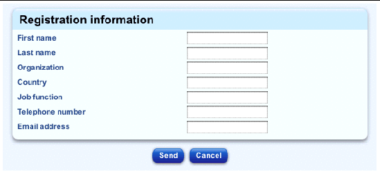

Registering the Sun Control Station software
To register your Sun Control Station software:
1. Select Station Settings > Information.
The System Information table appears.
2. Click Register Now below the table.
The Registration Information table appears; see FIGURE 2-5.
3. Fill in the following information.
4. Click Send.
The System Information table re-appears.
 FIGURE 2-5 Registration Information table
This screenshot shows the table for registering your Sun Control Station software; the buttons are Send and Cancel.

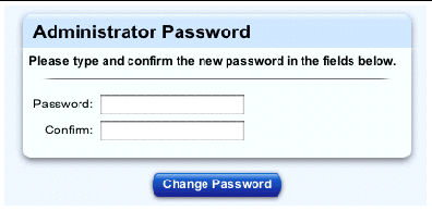

Password
To change the password for the Administrator:
1. Select Station Settings > Password.
The Administrator Password table appears; see FIGURE 2-6.
2. Modify the password.
Enter the password twice for confirmation.
For more information on choosing a password, see Password guidelines.
3. Click Change Password.
The system saves the configuration, refreshes the screen and displays the message "Password changed successfully".
 FIGURE 2-6 Administrator Password table
This screenshot shows the table for modifying the Administrator password; the button is Change Password.
