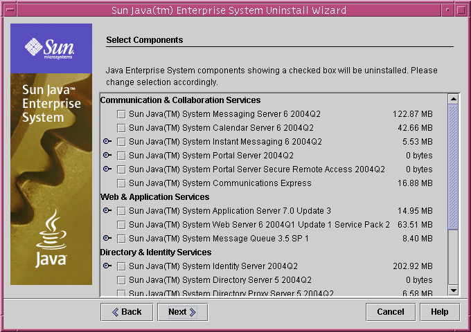

To Select Components to Uninstall
The Select Components page lists all possible Java Enterprise System components on your system.
- Examine the default selections and deselect any component product you do not want to uninstall.
- Component products that are installed on your system are automatically selected for removal. Component products that are not installed on your system are disabled and cannot be selected.
- Some component products contain subcomponents. You can expand these components to view the subcomponents.
- If all the subcomponents for a component are selected, you can deselect them all by deselecting the parent component.
- To select a component and all its subcomponents, expand the component and select each subcomponent. You cannot simply select the parent component.
- If you deselect a component that contains subcomponents, expand the component to verify the subcomponent list.
- After you are satisfied with your selections, click Next.

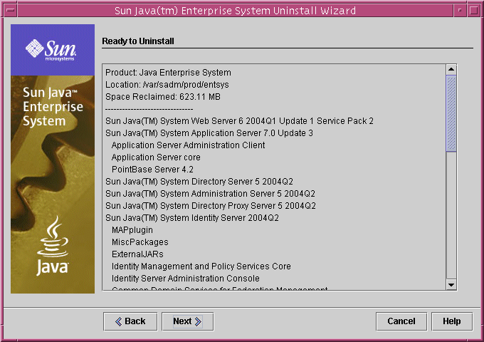

To Confirm Uninstallation Readiness
Before removing software from your system, the uninstaller displays the Ready to Uninstall page which shows the components you have selected for removal and the total disk space that will be reclaimed.
- Review the uninstallation selections you have made.
- If changes are needed, click Back through successive pages until the Component Selection page appears.
- Make changes as needed on the Component Selection page.
- Click Next to proceed again through the uninstaller pages.
The uninstaller remembers previously-specified values. You can modify any value you previously specified.
- At the Ready to Uninstall page, click Next when you are satisfied with your selections.
