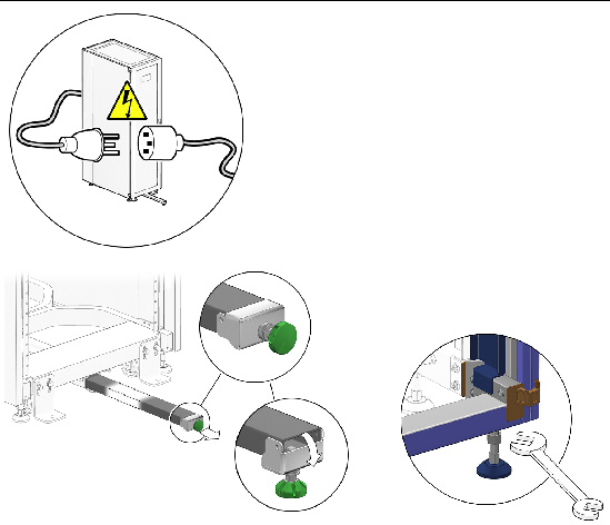

1. If necessary, remove all power, and disconnect all power and data cables from the Sun Rack and installed equipment.
Follow the manufacturer's recommended shutdown procedures before removing power from any equipment.
2. Pull out the end of the antitilt bar to the fully extended position (FIGURE 4-1).
3. Rotate the foot 90 degrees and adjust the height of the foot so that it rests on the floor.
4. If necessary, lower the four cabinet feet to contact the floor.
This figure shows the anti-tilt bar being extended and the foot rotating to contact the floor.
A wrench is used to lower the Sun Rack feet to the floor. FIGURE 4-1 Deploying the Antitilt Bar and Lowering the Sun Rack Feet

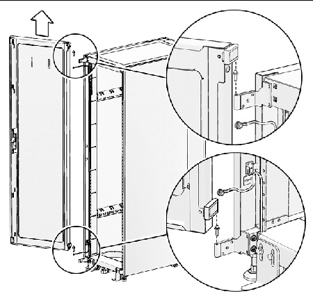

1. Using a 10 mm wrench, disconnect the front portion of the ground cable from the front door (FIGURE 4-2).
2. Lift the front silver alloy door off the hinges.
FIGURE 4-2 Removing the Silver Alloy Door and Ground Strap
Figure shows the ground strap disconnecting and the silver alloy door being lifted off the hinges.

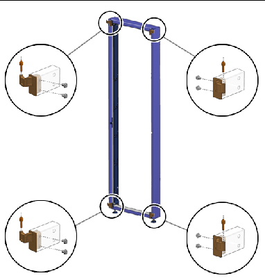

Note - Before you remove the gold hinges from the cabinet extension, be sure to look at the angle of the hinges. The cylinders always face away from the cabinet.
5. Remove all four gold hinges from the front of the cabinet extension (FIGURE 4-4).
FIGURE 4-4 Removing Four Gold Hinges from the Cabinet Extension
Figure shows removal of eight screws, four gold hinges, and four hinge pins from the front of the cabinet extension.

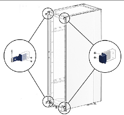

8. Install the two black latches on the right front of the cabinet extension (FIGURE 4-6).
9. Install the black and silver hinges on the left front of the cabinet extension.
FIGURE 4-6 Installing the Silver Alloy Hinges and Latches on the Cabinet Extension
This figure shows the silver and black hinges and latches being screwed into the cabinet extension.
