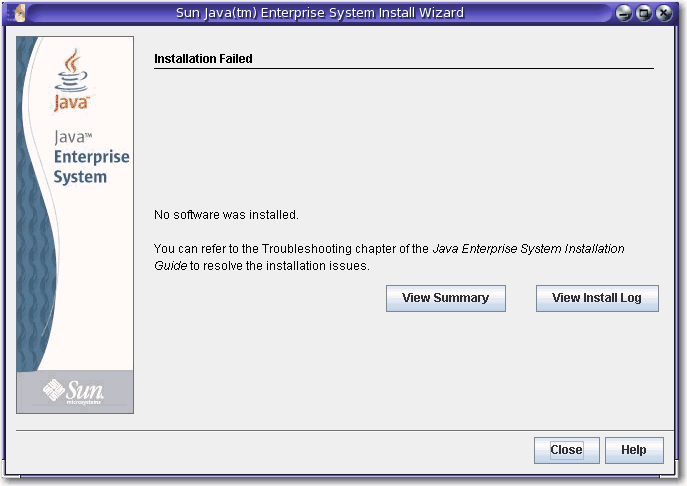

If installation is successful, the Installation Complete page is displayed. If installation is unsuccessful, the Installation Failed page is displayed.
Take action as desired:

If installation was unsuccessful, the Installation Failed page is displayed.
Click View Summary or View Install Log to access information that will help to diagnose the problems. For more information about using Java ES logs for troubleshooting, see Examining Installation Log Files.
