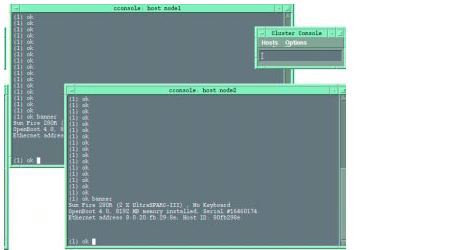

Use FIGURE 3-1 to record site-specific information that is needed to complete the procedures in this guide. Names and addresses shown in the center column represent the examples used in this guide. Assign names and addresses (routed or non-routed) that are appropriate for your site.
FIGURE 3-1 shows the location of the Ethernet address for the arrays.

4. Start the Cluster Control Panel:
# ccp $CLUSTER & |
This command displays the Cluster Control Panel (FIGURE 3-3).
5. In the Cluster Control Panel window, double-click on the cconsole icon to display a Cluster Console window for each cluster node (FIGURE 3-4).
To type text into both node windows simultaneously, click the cursor in the Cluster Console window and type the text. The text does not display in the Cluster Console window. This ensures that both nodes execute the commands simultaneously.
6. Use the ccp(1M) Cluster Console window to type the following command into both nodes simultaneously:
boot net - install |
boot net - You must use spaces before and after the dash (-) character in the
