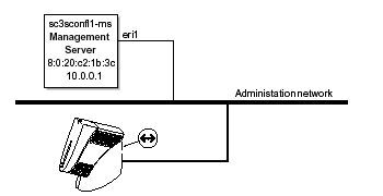

FIGURE F-1 shows the management server interface eri1 for the interconnect.
