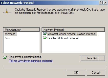

The Select Network Protocol dialog.

The Select Network Protocol dialog displays.
The Sun Blade 6000 10GbE VLAN driver installs.
