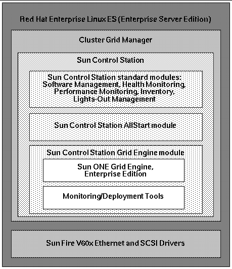

The following diagram represents the software components that are preinstalled on the CGM node and how they are related. The sections that follow give brief descriptions of the components that are labeled in the diagram.
Red Hat Enterprise Linux (Enterprise Server Edition) is the Linux operating system that is preinstalled on the CGM node of the system.
For detailed information about administering and customizing Linux operating system software, refer to the manual that was shipped with your Red Hat Enterprise Linux 2.1 media kit.
As shown in FIGURE 2-1, the Cluster Grid Manager software is comprised of several components that supplement each other to enable you to install, set up, and monitor activities on your Sun Fire V60x Compute Grid.
Sun Control Station and its standard control modules, plus the AllStart module and the Grid Engine module, comprise the Cluster Grid Manager interface that you use to administer your Sun Fire V60x Compute Grid. See FIGURE 2-2 for a sample Cluster Grid Manager main window.
You access the Cluster Grid manager main window by using a browser to go to the IP address of your CGM node (for example, http:\\n.n.n.n, where n.n.n.n is the IP address of your CGM node). Instructions for setting up the CGM node so that it can be correctly accessed are described in Logging In and Setting Up the System Identity.
Documentation for the Cluster Grid manager software components can be accessed with the Help button, which is the button with the question mark (?), in the upper-right corner (see FIGURE 2-2).

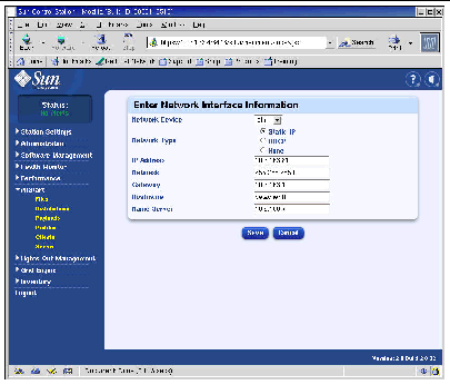

5. Configure an IP address for the CGM node as follows.
a. Change to the network-scripts directory.
# cd /etc/sysconfig/network-scripts/
b. Delete the ifcfg-eth0 file.
You can confirm the deletion by typing Y when prompted.
c. Edit the ifcfg-eth1 file to read as follows, substituting your IP address, netmask, and gateway information.
DEVICE=eth1
ONBOOT=yes
BOOTPROTO=static
IPADDR=n.n.n.n
NETMASK=n.n.n.n
GATEWAY=n.n.n.n
Where n.n.n.n represents the respective settings that are compatible with your local network. Use vi or another file-editing tool, such as Gedit, which is supplied with your Gnome desktop (start Gedit by typing gedit at a command line).

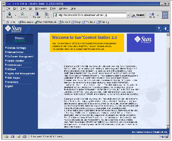

8. Read the Sun Control Station license agreement that appears and accept the license agreement if you agree with the terms.
A Sun Control Station Welcome page appears.

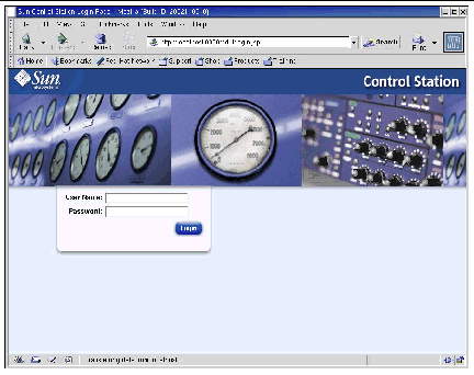

9. Go to the Sun Control Station login page for your CGM node by entering the URL in the format that is shown on the Welcome page:
Where n.n.n.n is the IP address that you assigned to the CGM node.
10. At the Sun Control Station login page (see FIGURE 2-3), log in as the SCS administrator using the default entries shown below, then click the Login button.
User Name: admin
Password: admin
11. After the SCS main window opens (see FIGURE 2-2), change the default SCS admin password to a password of your choosing, as follows:

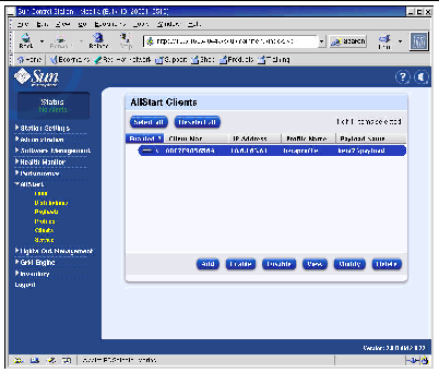

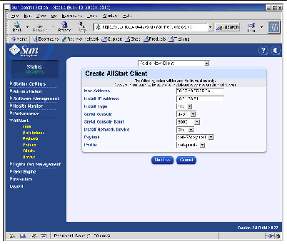

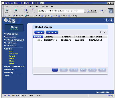

4. Creating and enabling clients to which you will load the payload. See Creating and Enabling Clients.

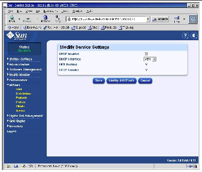

5. Defining network service settings for the network that your system is on. See Defining Network Service Settings.

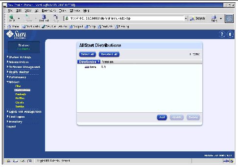

You must first define the software distributions that you will later load to the compute nodes.

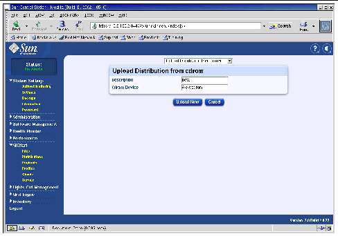

1. In the Cluster Grid Manager main window, select AllStart > Distributions from the left-side panel.
The AllStart Distributions window appears on the right side of the screen.
2. Click on Add at the bottom of the AllStart Distributions window.
The Upload Distribution From CDROM window appears on the right side of the screen.
3. In the Upload Distribution From CDROM window, fill in the fields to create a unique description for the distribution. See FIGURE 2-4 for an example.
The CDROM Device field should contain /dev/cdrom as the default entry.
4. Insert the Linux CD 1 into the CGM node, then click Upload Now.
A progress bar indicates the progress of the upload. If a file manager window opens when you insert the CD, you can close the file manager.
5. After the progress bar indicates that progress is 100%, click Done and remove the Linux CD 1 from the CGM node.
You are prompted to insert the next CD.
6. Insert the next CD in your Linux distribution, then click Continue.
7. Continue loading CDs when prompted until you have loaded the last CD in your Linux distribution, then click Done.
When uploading is complete, the distribution that you created appears in the list in the AllStart Distributions window. See FIGURE 2-5 for an example.

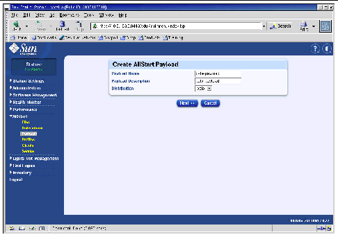

2. In the AllStart Payloads window, click Add.
The Create AllStart Payload window appears on the right side of the screen. See FIGURE 2-6 for an example.
3. In the Create AllStart Payload window, create the payload by filling in the fields and selecting the Linux distribution that you created.
4. When you are finished, click Next.

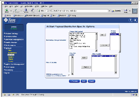

The AllStart Payload Distribution Specific Options window appears on the right side of the screen. See FIGURE 2-7 for an example.
5. In the Distribution Groups To Include list, select the groups that you require for the applications that you will use and move them to the Groups Loaded column.
You can select all groups by selecting the "Everything" option and moving it to the Groups Loaded column.
6. In the Files to Include list, verify that the Files Loaded selection list includes the
base-mgmt-agent RPM file.
If this file is not included, select it from the Files Not Loaded column and move it to the Files Loaded column.
7. Verify that the check-box for Sun Fire V60x/V65x server installation is selected.
This selection ensures that the required drivers for the Sun Fire V60x server are included.
8. When you are finished, click Save.

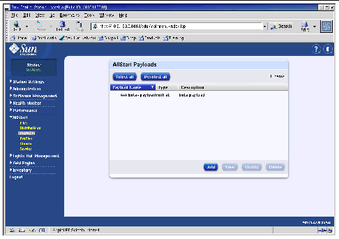

The payload is created, with the name you gave it.
9. Wait until the progress bar indicates 100%, then click Done.
When payload creation is complete, the payload that you created appears in the list in the AllStart Payloads window. See FIGURE 2-8 for an example.

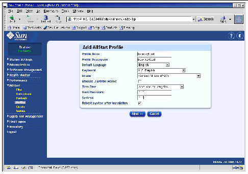

After the payloads have been defined, use AllStart to create installation profiles for the compute nodes.
1. From the left-hand menu click on AllStart > Profiles.
The AllStart Profiles window appears.
2. Click on Add at the bottom of the AllStart Profiles window.
The Add AllStart Profile window appears on the right side of the screen.

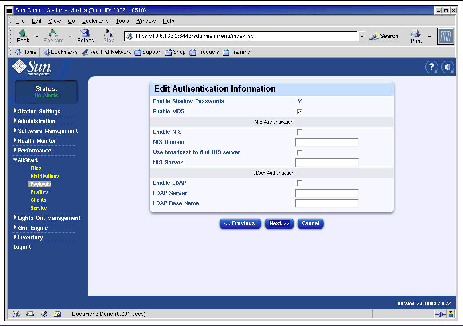

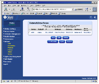

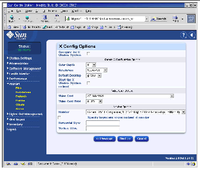

3. Create the AllStart profile by defining the options in the series of windows that appear.
a. In the Add AllStart Profile window, select the settings that are appropriate for your site (see FIGURE 2-9 for an example). Click Next when you are finished.
Note - If you use the KVM unit that is provided with the system, you must select "U.S. English" as the Keyboard type. |
b. In the Edit Boot Loader Options window, verify that the following required entries are selected (see FIGURE 2-10 for an example). Click Next when you are finished.

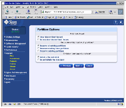

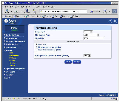

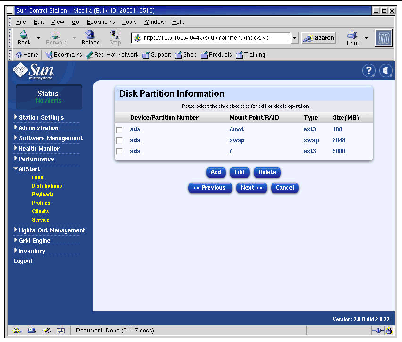

c. In the Partition Options window, verify that the following required options are selected (see FIGURE 2-11 for an example). Click Next when you are finished.
d. Use the Disk Partition Information window to create the partitions you require on the client node that you are installing to, as follows:
i. In the Disk Partition Information window, click Add.
The Partition Options window appears, where you define the parameters for one disk partition.
ii. Create your first disk partition by defining the partition parameters, then click Save when you are done. See FIGURE 2-12 for an example.
After you click save, you are returned to the Disk partition Information window, where the partition you created appears in the list (see FIGURE 2-13).
iii. To create another partition, click Add again in the Disk Partition Information window and define another partition as in Step ii.
Three different example partition configurations are listed as follows:
iv. After you have created all your partitions, click Next on the Disk Partition Information window.
e. In the Edit Authentication Information window, verify that the following required options are selected (see FIGURE 2-14 for an example). Click Next when you are finished.
f. In the X Config Options window, make the selection that you require (see FIGURE 2-15 for an example). Click Next when you are finished.

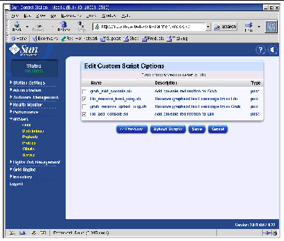

g. In the Edit Custom Script Options window, verify that the following required options are selected (see FIGURE 2-16 for an example). Click Save when you are finished.
These scripts enable serial redirection.

2. Click on Add at the bottom of the window.
The Create AllStart Client window appears in the right side of the screen.
3. In the Create AllStart Client window, create the client by defining the information for the node to which you will be loading the payload (see FIGURE 2-18 for an example). Verify that the following required options are selected:
4. When you are finished defining the Client options, click Next.
The Network Interfaces window appears.
5. In the Network Interfaces window, click Add.
The Enter Network Interface Information window appears.
6. In the Enter Network Interface Information window, create the network interface by defining the information for the node to which you will be loading the payload (see FIGURE 2-19 for an example).
Note - When you enter a host name, use the short host name format, not the full host name format that would include the domain name. |
7. When you are finished defining the network interface, click Save.
You are returned to the Network Interfaces window. The network interface that you created is listed (see FIGURE 2-20 for an example).
8. In the Network Interfaces window, click Save.

You are returned to the AllStart Clients page. The client that you created is listed (see FIGURE 2-21 for an example).
10. In the AllStart Clients window, select the clients that you want to enable, then click Enable.
A progress bar indicates the progress of the client enabling.
11. When the progress bar indicates 100%, click Done.
The client entry is enabled so that it is visible to that node in the system. Enabled clients are indicated by a Y character under the Enabled heading on the AllStart Clients window. See FIGURE 2-22 for an example.
12. Repeat Step 3 through Step 11 for all nodes in your system.

1. In the Cluster Grid Manager main window, select AllStart > Service from the left-side panel.
The AllStart Current Service Settings window appears on the right side of the screen.
The Modify Service Settings window appears.
3. In the Modify Service Settings window, make the following required settings (see FIGURE 2-23 for an example):
4. When you are finished with the settings, click Save.
A progress bar indicates the progress of the service setting.
5. When the progress bar indicates 100%, click Done.
The settings that you made are shown in the AllStart Current Service Settings window (see for an example).

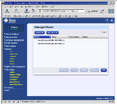

Use the following procedure to define the compute nodes of your system as SCS managed hosts.
Note - You cannot add the CGM node as an SCS managed host because it is the dedicated management node of the system, from which SCS managed hosts are managed. |
1. In the Cluster Grid Manager main window, select Administration > Hosts from the left-side panel.
The Managed Hosts window appears on the right side of the screen.

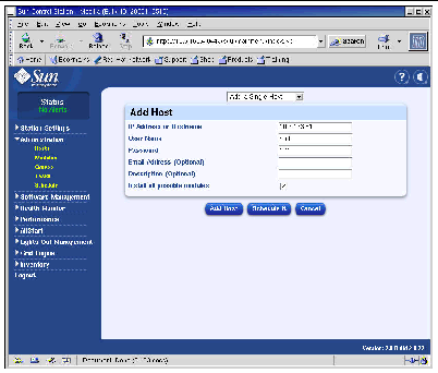

2. In the Managed Hosts window, click Add.
3. In the Add Host window, define the settings for the node that you are defining as an SCS managed host. See FIGURE 2-26 for an example.
4. Verify that the Install All Possible Modules box is selected.
This ensures that all of the SCS agents are installed on the newly managed host.
5. When you are finished with the settings, click Add Host.
A progress bar indicates the progress of the managed host addition.
6. When the progress bar indicates 100%, click Done.
You are returned to the Managed Hosts window. The managed host you added is listed (see FIGURE 2-27 for an example).
7. Repeat this procedure for all compute nodes in your system.

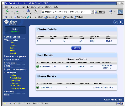

When you are finished with installing, your browser is redirected to the Grid Engine Monitor page (see Monitoring Compute Grid Tasks).
If, at a later point, you wish to add more nodes to the S1GEEE grid, you can return to the Install Compute Hosts page by clicking on the Grid Engine > Install Compute Hosts menu item in the left-side panel.
When you are finished with installation procedure, your browser is redirected to the Monitor page. From this page, you can view various S1GEEE statistics on your Sun Fire V60x Compute Grid. These include:
The Monitor page is automatically refreshed every two minutes. The information on the page is drawn from a database that is updated every two minutes. For every statistic, a time stamp is given to indicate when the statistic was last updated.
You can always return to the Monitor page by clicking the Grid Engine > Monitor menu item in the left-side panel. See FIGURE 2-2 for a sample Monitor window.
