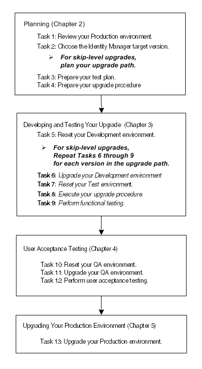

The following figure illustrates the skip-level upgrade process.
Figure 5-1 Skip-Level Upgrade Phases
For planning purposes, the first difference between a regular upgrade and a skip-level upgrade is in how you perform Task 2: Choose the Target Identity Manager Version. When choosing the target Identity Manager version, you must plan your upgrade path.
The next, and biggest, difference between the two upgrade processes is that you must perform Task 6: Upgrade Your Development Environment through Task 9: Perform Functional Testing for each stop in the upgrade path. You must upgrade your Development environment and your application baseline for the Identity Manager product version at each stop in the upgrade path. You probably also want to retest after each stop in the upgrade path, which requires resetting your Test environment and promoting your Identity Manager application to the Test environment after each stop in the upgrade path.
