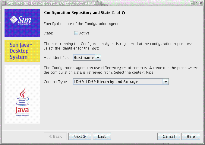

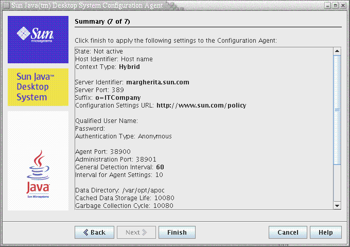

The configuration wizard offers a graphical user interface that guides you through the necessary settings of the Configuration Agent. For each page of the wizard, a corresponding help screen is available. You can start the wizard as super user (root) by means of the /usr/bin/apoc-config script.
The wizard can also be started without launching the graphical interface. For example, execute /usr/bin/apoc-config -nodisplay to start the wizard in console mode.
Associated property file keys are indicated in parentheses, where appropriate.
State: The status of the Configuration Agent. The check box can be used to either activate or deactivate the Configuration Agent. To make use of the configuration repository, the Configuration Agent must be active. The activation automatically includes the necessary registration with the service management facility ( smf(5) ) on Solaris.
Host Identifier (HostIdentifierType): can be ”HostName” or “IPAddress”. When searching for host-specific policy data, the Configuration Agent will identify the current host either by host name or IP address. Choose the correct value based on how your host is identified in the selected Context Type.
Context Type: Use this setting to indicate to the Configuration Agent whether your organizational hierarchy and configuration data are defined in LDAP or File-based storage or a mixture of both.

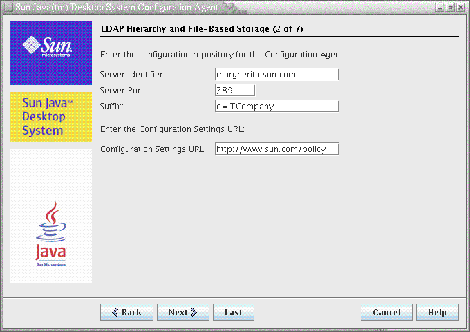

The screen in Figure 3–2 varies, depending on the Context Type chosen on the previous screen. Server Identifier, Server Port and Suffix are required if an LDAP or Hybrid context type is chosen. Configuration Settings URL is required if a File-based or Hybrid context type is chosen.
Server Identifier: host name of the LDAP server.
Server Port: port number of the LDAP server.
Suffix: base DN of the LDAP repository.
Configuration Settings URL: URL specifying the location of the file based repository.
A list of URLs can be used to specify fallback repositories in case the connection to the first one does not succeed. The list can be composed of one or more white space-separated URLs, each URL being of the form file://<filepath>, http://<host>:<port>/<filepath>, or https://<host>:<port>/<filepath>. See Appendix A, Configuration Parameters for more information.
The Agent tries to access the LDAP server using a SSL connection first. If this fails the Agent tries a plain SSL connection.
For the SSL connection to succeed, the proper certificate must be present in the Java runtime environment key store. That key store is located for a standard JRE in <installation directory>/lib/security/cacerts, and for a standard JDK in <installation directory>/jre/lib/security/cacerts. Either the Certification Authority or the LDAP server certificate must be added to that store, using the command keytool -import -file <certificate file> -keystore <cacerts file location>. The default password for that key store is changeit.

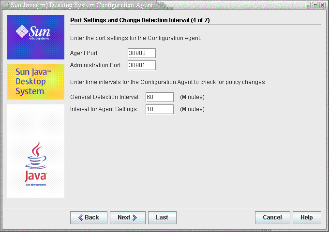

The Configuration Agent uses two ports:
Agent Port (DaemonPort): used by the agent to communicate with client applications (default is 38900).
Administration Port (DaemonAdminPort): used by the agent controller program, apocd, when communicating with the agent (default is 38901).
The Configuration Agent periodically checks for any changes in the configuration data using the following two intervals:
General Detection Interval (ChangeDetectionInterval): interval in minutes between the change detection cycles for the desktop application's (client's) configuration data.
Specifying -1 turns off change detection.
Interval for Agent Settings (DaemonChangeDetectionInterval): interval in minutes between the change detection cycles for the agent-specific configuration settings.
You can use the general detection interval to tune the propagation of remote configuration data changes to client side applications. The value provided for this setting is the maximum length of time in minutes that elapses before remotely made changes are reflected in the client applications.
Smaller values result in increased Configuration Agent and LDAP server activity. As a result, use caution when you adjust the value of the settings. For example, in an initial deployment phase, you can set the value to one minute so that you can test the impact of remote configuration on client applications. After you complete the testing, return this setting to the initial value.

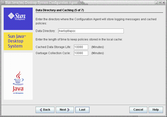

Data Directory (DataDir): the directory used to store runtime data. The default is /var/opt/apoc.
Cached Data Storage Life (TimeToLive): interval in minutes that non-offline configuration data remains in the local database.
Garbage Collection Cycle (GarbageCollectionInterval): interval in minutes between the garbage collection cycles in the local configuration database.

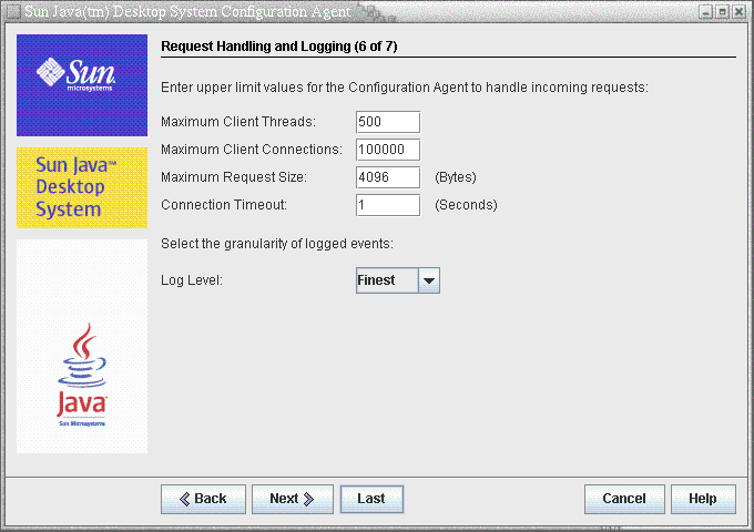

Maximum Client Threads (MaxClientThreads): maximum number of client requests that can be processed simultaneously.
Maximum Client Connections (MaxClientConnections): maximum number of client connections.
Maximum Request Size (MaxRequestSize): maximum size of client requests.
Connection Timeout (ConnectTimeout): denotes the allowed interval of the LDAP server to answer a connection request. The default is one second.
Log Level (LogLevel): level of detail in the agent log files. The logging level is consistent with the Java Logger levels. In order of decreasing severity, these levels are as follows:
SEVERE
WARNING
INFO
CONFIG
FINE
FINER
FINEST
