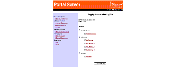

Figure 10-1    Logging Servers: show log files
Any application in iPlanet Portal Server that uses the Logging API can create logs and maintain history log segments. The log files are stored by default in flat files in the directory /var/opt/SUNWips/logs, although another location can be specified through the admin console. The product can also be configured to log data to a database. The files can not be deleted manually because the log names are stored in the Profile database.
The log files are maintained by a dedicated log server. Since it operates on the same network as other iPlanet Portal Server components, log server performance may be affected by network traffic.
Manage Logging Profile
Clicking on the Logging link on the Admin Console menu causes the Manage Logging link to appear. Beneath the link is a link for each host. Selecting a host link calls up the Logging Servers: show log files page, as shown in Figure 10-1. From this page, logs can be viewed and deleted.
Note Only the Super Administrator can delete logs. A Domain Administrator can only view logs when permissions are set (default). The iwtgateway logs are not viewed by the Domain Administrator.

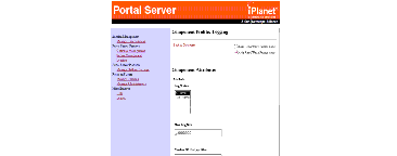

At the top of the page a logging active or in active status is noted for this particular server. If it is not active, that doesn't mean the log files for that server don't exist, only that logging is turned off. Logging can be turned on or off for a particular server by changing the ACTIVE/INACTIVE log status attribute from the Component Profile: Logging window within the Manage Logging Profile link, as shown in Figure 10-2.
Figure 10-2    Component Profile: Logging

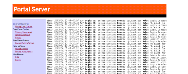

Figure 10-3    iwtAuthentication Log
When a particular log file link is clicked, the contents of that file are displayed in a window. For instance, Figure 10-3, shows the current contents of the Authentication log file for a particular server. For this log file, the log information displayed includes:
Log date and time
One or all of the log files on a server can be deleted by clicking the checkbox next to the name of the log file and then clicking the Delete Selected Logs button.Client domain from where the access to portal server has been made
Client login id (the userid specified to log in to the portal server)
Log type (type of log message, such as Auth for authentication)
Managing the Logging Profile
Clicking on the Manage Logging Profile link on the main Logging window lets you change the server's logging attributes.Log information can be kept in either a flat ASCII file or in a database. If you want to keep a server's log information in a database, see the section below.
The attributes that you can change for a logging profile are summarized in Table 10-1:
Attributes for the logging files for a server are normally inherited from the default platform settings, but can be changed to reflect the needs of a particular server. You can also delete a log file by selecting it and clicking the Delete button.
The Show and Hide Read/Write Permissions checkboxes tell you whether administrators or users are allowed to read and write the log files.
