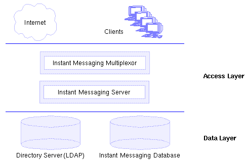

Two-tiered Architecture
A two-tiered architecture splits the Instant Messaging server deployment into two layers: an access layer and a data layer. In a simplified two-tiered deployment, you might add one or more multiplexors and servers to the access layer. The multiplexor acts as a proxy for users, and the relays messages to the Instant Messaging server. The data layer holds the Instant Messaging server database and Directory servers. Figure 3-1 shows a simplified two-tiered architecture.
Figure 3-1 Simplified Two-tiered Architecture
Two-tiered architectures have advantages over one-tiered architectures that can impact your sizing decisions. Two-tiered architectures:
To Size Your Multiplexing Services
When you size your multiplexor, the calculation is based on your system load, particularly the number of concurrent connections the multiplexor needs to handle.
In addition, you must:
- Add CPU or a hardware accelerator for SSL if appropriate.
- Add memory to the machine if the multiplexor is being configured on it.
- Account for Denial of Service.
- Add capacity for load balancing and redundancy, if appropriate.
One or more of each type of machine should still handle peak load without a substantial impact to throughput or response time when you plan for redundancy in your deployment.
