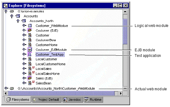

Assuming that you have let the wizard place what it produced in the bean's package, the generated objects for a bean named Account in a package named Accounts_North would look like the example in FIGURE 9-1.
 FIGURE 9-1 Example of Test Objects Generated for Enterprise Beans
Screenshot showing an example enterprise bean with its generated testing objects in the Explorer.
Notice the generated objects that have been added to the bean's package:
Unless you specified otherwise in the wizard, the IDE has placed the actual web module (containing JSP pages and helper Java classes) in a new filesystem of its own.

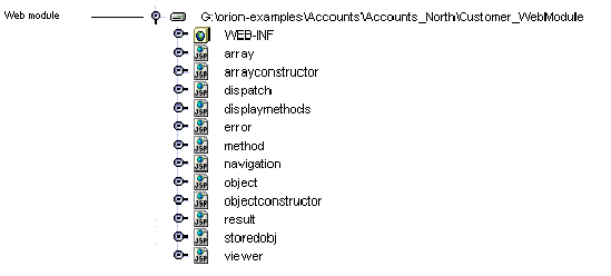

Notice also that the wizard created a new filesystem to contain the web module and other objects for use in testing. When you expand the filesystem node, you see the web module as the first subnode. This web module, shown next, contains the JSP pages and helper Java classes.
Screenshot showing the web module node expanded in the Explorer.[ D ]

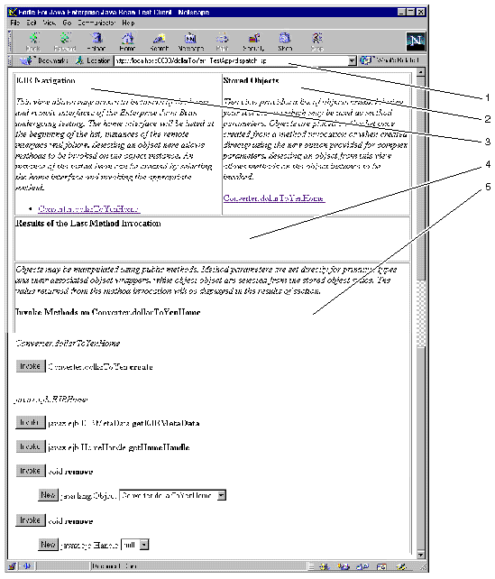

FIGURE 9-2 shows an example of a JSP page that the IDE has created for the application client that was generated to test the example session bean.
 FIGURE 9-2 Client JSP Page Generated to Test Simple Session Bean dollarToYen
Screenshot showing the JSP page generated to test a simple session bean.[ D ]
As shown in FIGURE 9-2, the parts of the testing window are as follows:
1. The browser's URL field shows the location of the test client's JSP page. Your client's URL is generated automatically by the IDE's testing feature. If you like, you can use this URL to return to this testing window.
2. The Stored Objects frame shows the stack of objects created during your testing sequence by the IDE or by your own actions, for example, when you have called a method on an interface or on a bean class. Right now, only the home interface is shown.
You can remove objects from the Stored Objects stack by using the Remove Selected or Remove All button.
3. The EJB Navigation frame shows the objects that the IDE has generated so that you can test your bean. If the bean you're testing has references to other beans and your EJB module contains more than one bean, this frame lists the created objects in logical order, that is, in the order that one bean in the module calls another.
In the EJB Navigation frame in FIGURE 9-2, you see Converter.dollarToYenHome, which shows that the IDE has created the session bean's home interface. Later, you will click this home interface to create and initialize a new instance of the session bean.
When you see more than one object listed in this frame, you click an object to change focus to the bean component you want to test. When you click an object, notice how the other frames change.
4. The Results of the Last Method Invocation frame shows, for example, the last method you called and its parameters. Right now, since we haven't yet begun testing the session bean, nothing appears in this frame.
5. The bottom frame shows the methods that are now available for you to test. This frame changes as you place focus on different components of the bean (listed in the EJB Navigation frame).

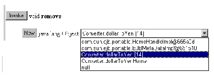

Creating New Testing Classes
When you create an object by invoking the bean's other methods, that object can be used to test the bean further. For example, the objects created so far by testing Converter.dollarToYen also appear in a combo box, as shown in the following example. You can select one of the objects and create a new class to use for testing.
Screenshot showing the Invoke Methods on Bean Name frame with possible new classes offered for selection.

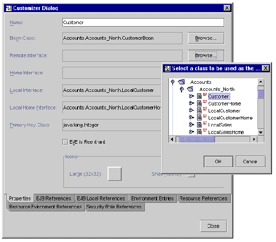

4. In the Explorer, right-click the bean's logical node and choose Customize.
The Customizer dialog box appears.
Notice that the Customizer deals with many of the properties also available in the property sheet that appears when you right-click the bean's logical node and choose Properties. You can change many of the bean's properties in either dialog box. However, the Customizer does deals only with properties on the bean itself, not with properties relating to application servers. Also, if you want to add remote interfaces to a bean, you can do so only in the Customizer.
5. In the Customizer dialog box, find the empty Remote Interface field and click the Browse button.
The Select a Class file chooser appears, as shown in FIGURE 9-3.
 FIGURE 9-3 Customizer for Adding an Interface Class to a Bean
Screenshot showing two dialog boxes: the Customizer and a file chooser.[ D ]
6. Navigate to the interface class you created by copying and pasting. Select the interface node and click OK.
The class appears in the Remote Interface field.
(You will see later that the Remote Interface field in the bean's property sheet has automatically been updated.)
7. Dismiss the Customizer dialog box.
