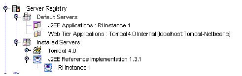

The Server Registry Node
At the top level is the Server Registry node. This node groups the other server- related nodes. It has no commands or properties of its own. FIGURE 9-1 shows the Server Registry with its default subnodes.
 FIGURE 9-1 Server Registry and Default Subnodes
Screenshot of a section of the Explorer window, runtime tab, showing the Server Registry Node and its default subnodes.	[ D ]

Server Product Nodes
These are the subnodes of the Installed Servers node. Each of these nodes represents a web or application server product that is recognized by the IDE. (These nodes actually represent the presence of a IDE plugin module that is capable of interacting with the specified server product. For more information on server plugins, see Appendix A.) FIGURE 9-1 shows the IDE after default installation, with Installed Server nodes for the Tomcat web server and the J2EE RI application server.

Default Server Nodes
These nodes represent the server instances currently designated as the default server instances. When a server instance is the default server instance, applications are deployed to this instance unless you specify otherwise. (Application nodes have an Application Server property. The default value of this property is Default Server. You can change this value to the name of any server instance node.)
To make a server instance the default server, right-click the server instance node and then choose Make Default from the contextual menu. In FIGURE 9-1 shows the default server for J2EE applications is RI Instance 1.

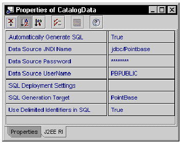

The modules and applications you work with have property sheets, which you use to describe the services your modules and applications need from the application server. In addition to the Properties tab, which shows the properties defined by the J2EE specifications, these property sheets have server-specific tabs, which show properties that prompt you for information needed by a server product.
For example, FIGURE 9-2 shows an EJB module property sheet with the J2EE RI tab selected. The module contains some CMP entity beans, and most of the properties on this tab are used to supply information needed by the J2EE RI implementation of container-managed persisitence.
 FIGURE 9-2 EJB Module's J2EE RI-specific Properties
Screenshot of the EJB module's property sheet with J2EE RI-specific tab selected.
