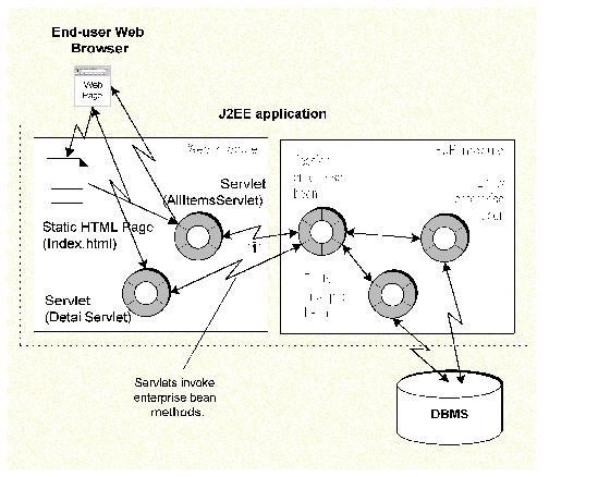

FIGURE 4-1 shows a web module and an EJB module assembled into a J2EE application. The interaction between the modules is Java RMI; servlets in the web module make remote method calls to the EJB module. The other interactions that appear in the figure, the HTTP requests and responses between the user's browser and the application, and the database queries that the application executes, were programmed in the modules.
 FIGURE 4-1 Web Module and EJB Module Assembled Into J2EE Application
Diagram of the J2EE application covered in this chapter, containing a web module and an EJB module.[ D ]
The Interactions in This Application
This scenario looks at a J2EE application that participates in all the interactions shown in FIGURE 4-1. The programming required for the HTTP interactions with users is inside the web module, and it is covered in . The programming required for the interaction with the database is inside the EJB module, and it is covered in Chapter 3. This scenario is about assembling the two modules into a J2EE application.
The one interaction that depends on both of the modules is the remote method call between the modules. The parts needed for this interaction are already in the modules. The web module contains JNDI lookup code and an EJB reference declaration (see ), and the EJB module contains remote interfaces that support remote method calls (see Creating Remote Interfaces for the Session Enterprise Bean).

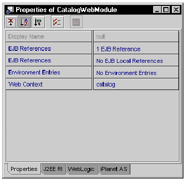

  • The web context is a string that you specify as a property of the module, after you add the module to a J2EE application. It qualifies all of the web resources in your module.
  • The URL Pattern is a string mapped to a specific servlet on the web module's property sheet. See .
In other words, the URL patterns assigned on the web module's property sheet are relative to the context that you assign with this procedure. To set the web context:
1. Right-click the included web module node (the web module node under the J2EE application node), and choose Properties from the contextual menu.
2. Click the Web Context property and type in the string you want to use.
FIGURE 4-2 shows the property sheet for the catalog web module. The web context is set to catalog.
 FIGURE 4-2 Property Sheet for Catalog Web Module
Screenshot of Property sheet for the catalog web module. The Web Context field has the value catalog.
With this value, URLs for web resources in the application will have this general form:
http://hostnmame:port/catalog/URL_pattern
If you don't supply a web context, it defaults to blank, and URLs for web resources in the application would have this general form:
http://hostnmame:port/URL_pattern

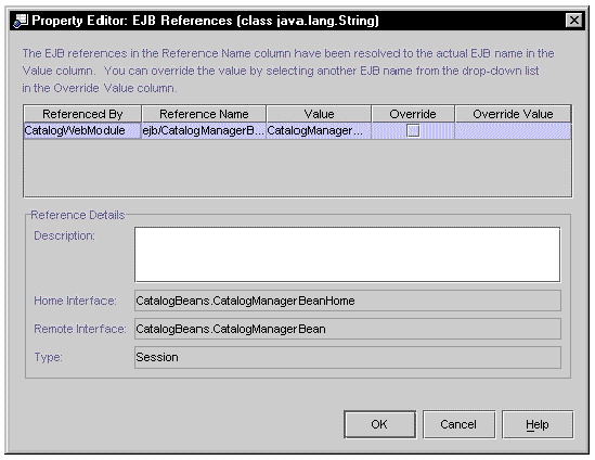

1. Open the application's EJB References Property Editor.
Right-click the application node, and then choose the following sequence from the contextual menu: Properties right arrow EJB References right arrow ellipsis (...) button.
2. Check the status of the EJB references.
This editor shows you all of the references that have been declared in the modules that make up the application. References are identified by module and reference name (the name used in the JNDI lookup statement).
FIGURE 4-3 shows this property editor for the modules in this scenario. There is one EJB reference, in the CatalogWebModule. The reference is named ejb/CatalogManagerBean, and it is resolved by an enterprise bean in the EJB module, named CatalogBeans.CatalogManagerBean.
 FIGURE 4-3 Application Node's EJB References Property Editor
Screenshot of the application node's EJB references property editor with a linked reference.[ D ]

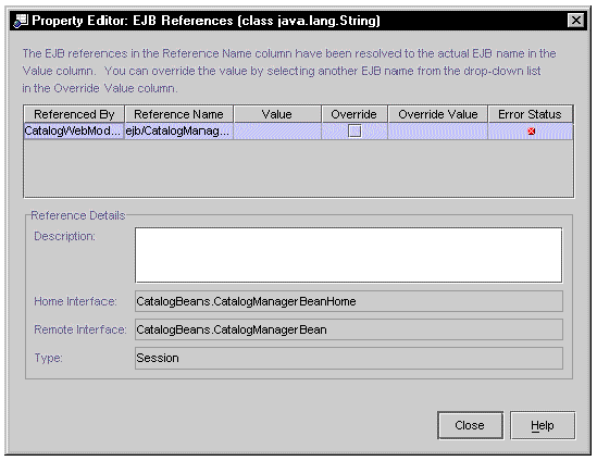

If a reference has not been linked, its Value field will be empty, and the Error Status field will indicate a problem with the references. FIGURE 4-4 shows the same reference, but in this case it was not linked on the web module property sheet.
 FIGURE 4-4 Unlinked EJB Reference
Screenshot of the application node's EJB references property editor with an unlinked reference.[ D ]
3. Link any unresolved references.
To do this, click the Override Value field. It will display a list of enterprise beans in the application that implement the interfaces specified in the reference. Select one of these enterprise beans. When the application executes, the method calls coded in the web module will call the enterprise bean you select here.

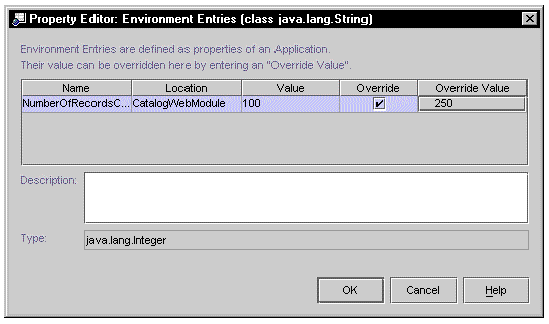

If the application contains any environment entries, you might want to revise the values that were set for them on the module property sheet. You can do this on the application's Environment Entries Property Editor. (To open this editor, right-click on the application node, and then choose the following sequence from the contextual menu: Properties right arrow Environment Entries right arrow ellipsis (...) button.)
This editor shows you all of the environment entries that have been declared in the modules that make up the application. Environment entries are identified by name (the name used in the JNDI lookup statement) and module.
FIGURE 4-5 shows this property editor for the modules in this scenario. There is one environment entry, that was created on the web module's property sheet. (See .) The reference is named The environment entry is named NumberOfRecordsCached and it has a default value of 100, set on the web module's property sheet.
 FIGURE 4-5 Application Node's Environment Entries Property Editor
Screenshot of J2EE application property sheet showing an override value.[ D ]
If you are working with the web module source files in your development environment you can change this value on the module's property sheet. If there is any chance that the web module will be used in more than one application, however, you are better off customizing this value on the application's property sheet. If the next person to use the web component changes the value on the module property sheet, it will change the value in your application when you redeploy.
To override the value set on the module property sheet, click the checkbox in the Override column and then supply the override value in the Override Value field.
