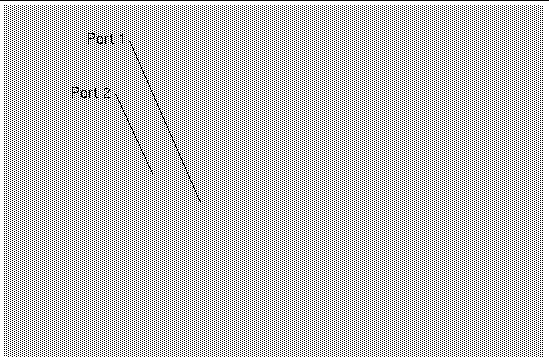

1. Connect the fiber-optic cable to an LC connector on the dual port HBA (see FIGURE 3-3).
FIGURE 3-3 Attaching the Optical Cable
2. Connect the other end of the cable to the Fibre Channel device.
