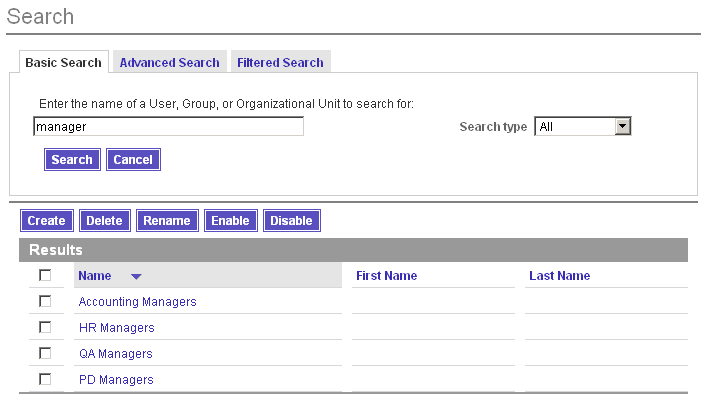

Executing a Basic SearchUse the Basic Search tab (the default page) to search for users, groups, or organizational units.
Figure 6-1 Search Results
To perform a basic search, use the following steps:
- Enter the name of a user, a group, or an organizational unit into the text field provided.
For example, type manager for a list of all objects that have “manager” in their name.
- Select a Search Type from the drop-down menu.
- Click the Search button or press Return (Enter) on your keyboard and the search results will display in table-format at the bottom of the Search page.
For example, the following figure shows the result of searching for manager.
Figure 6-2 Search Results

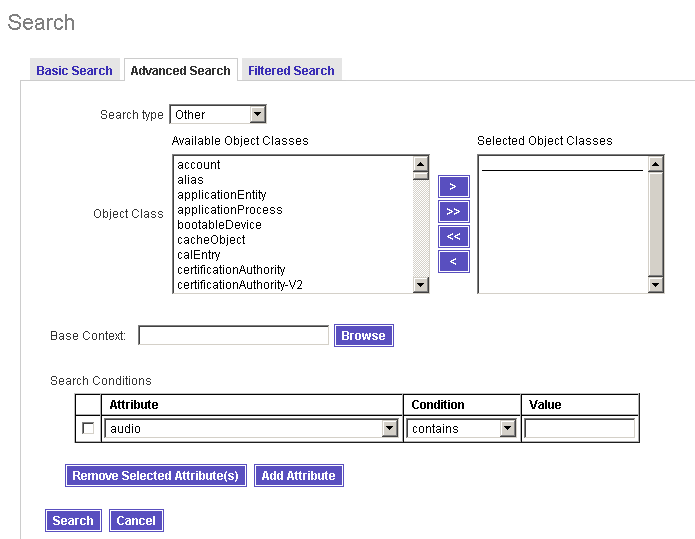

Executing an Advanced SearchSelect the Advanced Search tab to search for objects by specifying search conditions, which can be combined with and operations.
Figure 6-3 Advanced Search Tab
To configure and execute an advanced search, use the following steps:
- Select one of the following object types from the Search type menu:
- User
- Group
- Organizational Unit
- Other
When you select the Other option, the Object Classes selection tool displays (similar to the one shown in the following figure).
Figure 6-4 Selecting Object Classes
- You can select object classes from the Available Object Classes list and click the Add button
to move the object classes to the Selected Object Classes list.
- Click Add All
to move all available object classes to the Selected Object Classes list.
- Click Remove All
to move all object classes from the Selected Object Classes list back to the Available Object Classes list.
- Select object classes from the Selected Object Classes list and click Remove
to move the object classes from the Selected list back to the Available Object Classes list.
- Enter a Base Context in the text box provided (or click Browse to search the organizational units in the directory).
The Search will return results from items in this container and “contained” containers.

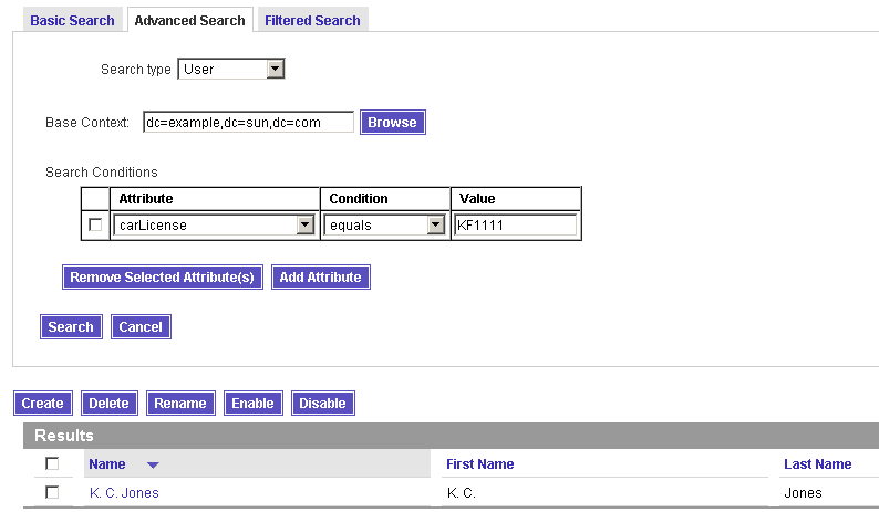

Following are several examples of an Advanced Search.
Someone reports a “fender-bender” in the parking lot and you want to notify the car owner. You could specify the following parameters to identify the owner:
The following figure shows the result of searching for the license number:
Figure 6-5 Example 1 Search Results

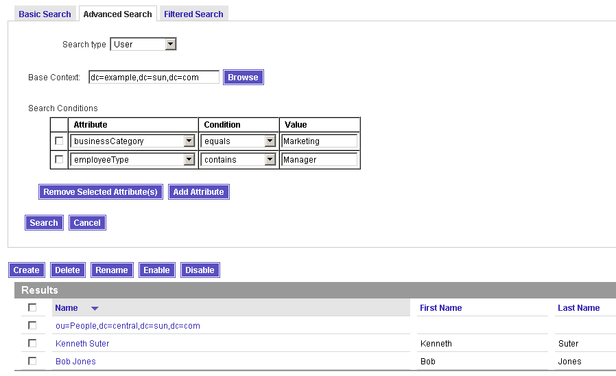

You want to send an email to all Marketing managers. You could specify the following parameters to identify these managers:
The following figure shows the result of searching for Marketing managers:
Figure 6-6 Example 2 Search Results

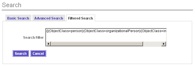

Executing a Filtered SearchSelect the Filtered Search tab to specify free-form query strings to search for objects in the directory.
Figure 6-7 Filtered Search tab
Use the default search string or enter your own query in the Search Filter text field.
For example, if you want to search for all groups in the directory, type the following text in the Search Filter text field and click Search:
(|(ObjectClass=groupofnames)(ObjectClass=groupofUniqueNames))
Note
You can change the default search string using the Search Configuration page (Configure > Search Options). See Specifying Default Settings for more information.
The following figure shows the result of the filtered search.
Figure 6-8 Example Filtered Search Results

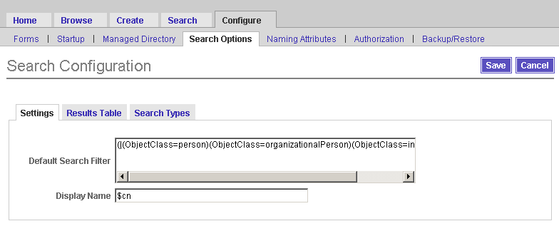

Editing the Search Page ConfigurationThe procedures in this section describe how to change the appearance and content of your Search page. The information is organized as follows:
Accessing the Search Configuration Page
To open the Search Configuration page, select the Configure > Search Options.
The Search Configuration page is displayed as follows:Figure 6-9 Search Configuration Page
This page contains three tabs:
Use the following procedure to configure a default search filter for the Search page.
- Select the Settings tab (see Figure 6-9).
- Modify the default filter shown in the Default Search Filter text box or enter a new filter.
- Modify or enter a new display name in the Display Name text box.
You may want Directory Editor to return results in the same way your company displays data. For example; cn, uid, and so forth.
- You can click Save to apply your changes (or click Cancel and return to the Home page).
From here, you can select another tab to continue configuring your Search page.

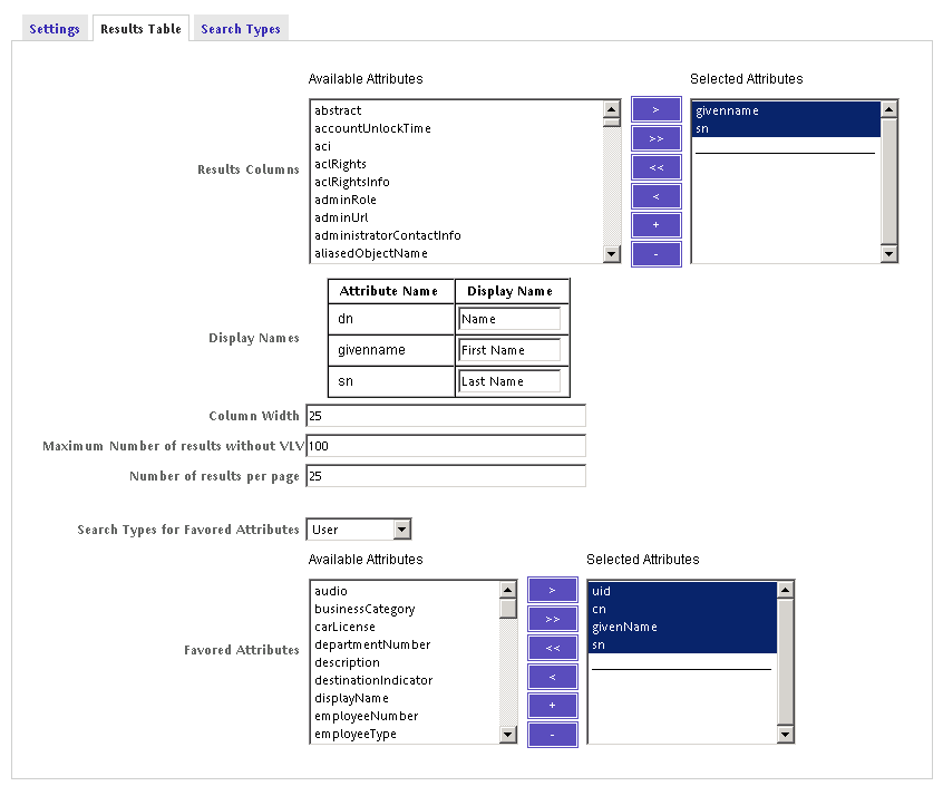

Configuring the Results Table
Use the following procedure to configure a results table for the Search page.
- Select the Results Table tab.
Figure 6-10 Results Table Page
- Use the Results Columns selection tool to add attributes to or remove attributes from the Selected Attributes list, as follows:
- Select one or more attributes from the Available Attributes list and click the
button to move them to the Selected Attributes list. (Press your Shift key and click on items in the list to select multiple attributes.)
- Click the
button to move all available attributes to the Selected Attributes list.
- Click the
button to move all attributes from the Selected Attributes list back to the Available Attributes list.
- Select one or more attributes from the Selected Attributes list and click the
button to move them back to the Available Attributes list.
- Use the
(move up) and
(move down) buttons to change the order of attributes in the Selected Attributes list.
- By default, Directory Editor populates the Display Names table with Attribute Names and Display Names.
You can replace the default names in the Display Names column by typing directly into the text boxes provided.
- Enter a value in the Column Width field to specify a maximum width (maximum character length) for columns in the Results table.
- Enter a value in the Maximum Number of results without VLV field to specify the maximum number of search results (how many lines) to display in the Results table if you are not using the Virtual List View LDAP protocol facility.
Note
For more information about VLV, see Appendix C, "Improving Performance of Browse and Search Features" and the Sun Java System Directory Server product documentation.
- Enter a value in the Number of results per page field to specify the maximum number of search results (how many lines) to display in the Results table on a single page.
If search results exceed this maximum number of lines, Directory Editor will continue the Results table on a new page. Use the navigation tool to view the different pages as follows:
- Use the Search Types for Favored Attributes menu to select an attribute type (User, Group, or Organization) for the favored attributes to be selected in Step 8.
- Use the Favored Attributes selection tool to specify which attributes are available (and the order in which they display) when you click the Add Attributes button on the Advanced Search page:
- Click the
- Click the
- Use the
(move up) and

- Click the Remove Selected Types button located beneath the table.
Directory Editor immediately removes that row from the table.
- Click Save to save your changes and return to the Home page, or click Cancel to undo your changes and return to the Home page.
