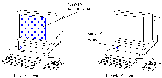

You can start, view, and control SunVTS testing sessions over a network. There are several ways to do it, but the desired effect is to have SunVTS display the SunVTS user interface on the local system (the system that you are on), while the SunVTS kernel is running and testing a remote system (connected via Ethernet, modem lines, and the like).
The following procedures are described in this section:
In addition to the normal SunVTS requirements (refer to Section 3.2, Requirements for Starting SunVTS), the following requirements must be met to run SunVTS on a remote system:
The user or host making the remote connection must be an authorized SunVTS user, either through the .sunvts_sec file (basic security), or through the SEAM security scheme. See Section 2.4, SunVTS Security.
The same version of SunVTS must be installed on both the local and remote systems.
1. Type the following command:
Replace remote_hostname with the hostname or IP address of the remote system.
The sunvts command starts the SunVTS kernel (vtsk) on the remote system, and starts the SunVTS user interface on the local system. The user interface connects to the kernel and the displays the test session of the remote system. Refer to FIGURE 3-1 below.
The term system under test (SUT) refers to the system running the SunVTS kernel, which is the remote system in this example.
