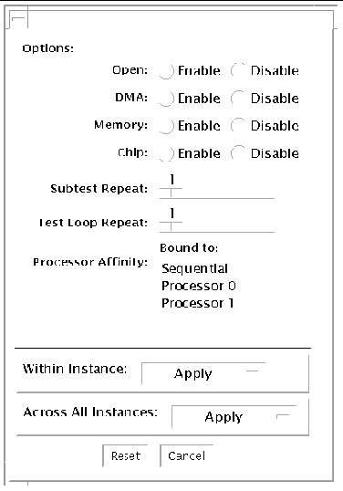

To reach the following dialog box, right-click on the test name in the System Map and select Test Parameter Options. Because graphics test can test multiple types of frame buffers, the test name that is displayed will correspond to the particular frame buffer being tested. If you do not see this test in the System Map, you might need to expand the collapsed groups, or your system might not include the device appropriate to this test. Refer to the SunVTS User's Guide.
By default, all graphicstest options are enabled.
FIGURE 21-1 graphicstestkfb0 Test Parameter Options Dialog Box
Due to the nature of graphic tests, reading data from, or writing data to the frame buffer during graphic tests disturbs user operation. For this reason, graphicstest is only available in Functional test mode.
