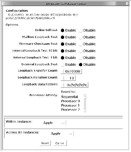

To reach the following dialog box, right-click on the test name in the System Map and select Test Parameter Options. If you do not see this test in the System Map, you might need to expand the collapsed groups, or your system might not include the device appropriate to this test. Refer to the SunVTS User's Guide for more details.
FIGURE 48-1 qlctestTest Parameter Options Dialog Box

Fcode revision check
Retrieves the fcode revision string. This core subtest is always run but not shown in the options dialog box.
Firmware revision check
Retrieves the firmware revision string. This core subtest is always run but not shown in the options dialog box.
Board revision check
Retrieves the board revision levels. This core subtest is always run but not shown in the options dialog box.
Selftest
Evaluates the functionality of ISP hardware by performing the following tests:
- Transmit FIFO test
- Receive FIFO test
- SRAM test
- Misc. Register tests
Enabled by default, but can be deselected.
Mailbox Loopback subtest
Loads a series of registers into the input mailboxes on the card and then reads the output mailboxes and compares results. This verifies that the system side of the card is operating correctly, and that the internal data paths are correct. Enabled by default, but can be deselected.
Firmware Checksum subtest
Runs an internal checksum test on the installed firmware. This verifies that the RISC RAM on the card is fully functional and that the installed firmware is still intact. This test also serves as a quick RAM check of the RISC RAM. Enabled by default, but can be deselected.
Internal 10-bit Loopback subtest
Performs internal loopback test within the host adapter ISP hardware at the 10-bit interface. This test is done with data sourcing from the system memory and going to the system memory. The desired data pattern, transfer length, and iteration count can be selected via the test parameters menu. Enabled by default, but can be deselected.
Internal 1-bit Loopback subtest
Performs internal loopback test within the host adapter ISP hardware at the 1-bit interface. This test is done with data sourcing from the system memory and going to the system memory. The desired data pattern, transfer length, and iteration count can be selected via the test parameters menu. Enabled by default, but can be deselected.
External Loopback subtest
Performs an external loopback test. This test is performed with data sourcing from the system memory and going to the system memory. The desired data pattern, transfer length, and iteration count can be selected via the test parameters menu. This is an intervention test, because a loopback cable is needed from the transceiver to the receiver of the QLC port when testing this port by itself. This subtest can also test the entire fibre channel loop when the loop is connected to the storage to be tested. Not enabled by default, but can be selected.
Loopback Transfer Count
Controls the packet size used in the internal 10-bit, internal 1-bit, and external loopback tests. Default value is 0x10000.
Loopback Iteration Count
Sets the number of times to loop the internal 10-bit, internal 1-bit, and external loopback tests. Default value is 10.
Loopback Data Pattern
Selects the data pattern to loop for the internal 10-bit, internal 1-bit, and external loopback tests. Default value is 0x7e7e7e7e.
