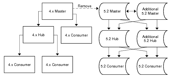

Figure 4-8 shows the addition of a master, a hub and additional replication agreements to the new topology.
Figure 4-8 Adding Servers to the 5.2 Topology
You may also add additional servers after completing the upgrade process.
Figure 4-9 shows removal of the replication agreement from the old 4.x master to the new 5.2 master.
Figure 4-9 Removing the Replication Agreement
After redirecting client requests and removing the replication agreement, you may disable the 4.x servers. Figure 4-10 shows the resulting 5.2 topology.
Figure 4-10 Resulting 5.2 Topology
