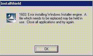

Installation Failure
Installation can fail due to Windows Installer error.
- Error 1603 - Fatal error during installation: This can happen due to any of the causes mentioned at the Microsoft website: http://support.microsoft.com/default.aspx?scid=kb;en-us;834484
Refer to http://support.installshield.com/kb/view.asp?articleid=Q107319 to troubleshoot these errors.
