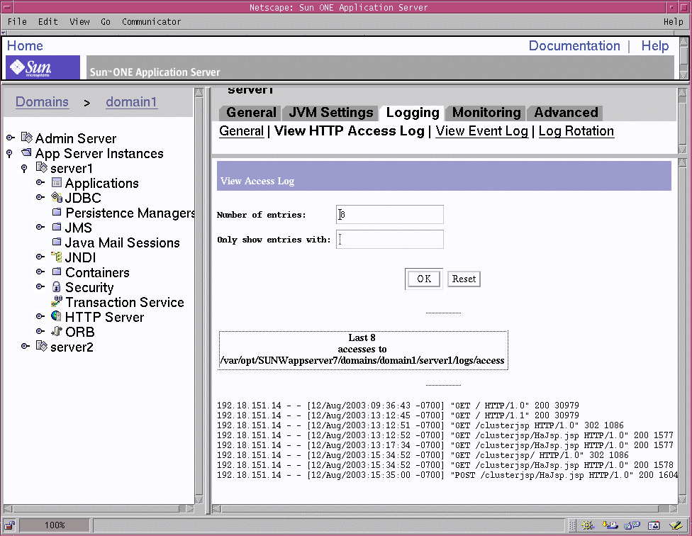

To use the Administration interface to view the HTTP access log for an application server instance:
The HTTP access log for a server instance shows the accesses to the sample application made for the server instance.
The name of the access log is access. By default, the access log file is located in the same directory as the server event log:

When you run the Cluster JSP sample, access log messages are logged to the application server instance that served the request:
192.18.151.14 - - [12/Aug/2003:15:34:52 -0700] "GET /clusterjsp/ HTTP/1.0" 302 1086
192.18.151.14 - - [12/Aug/2003:15:34:52 -0700] "GET /clusterjsp/HaJsp.jsp HTTP/1.0" 200 1578

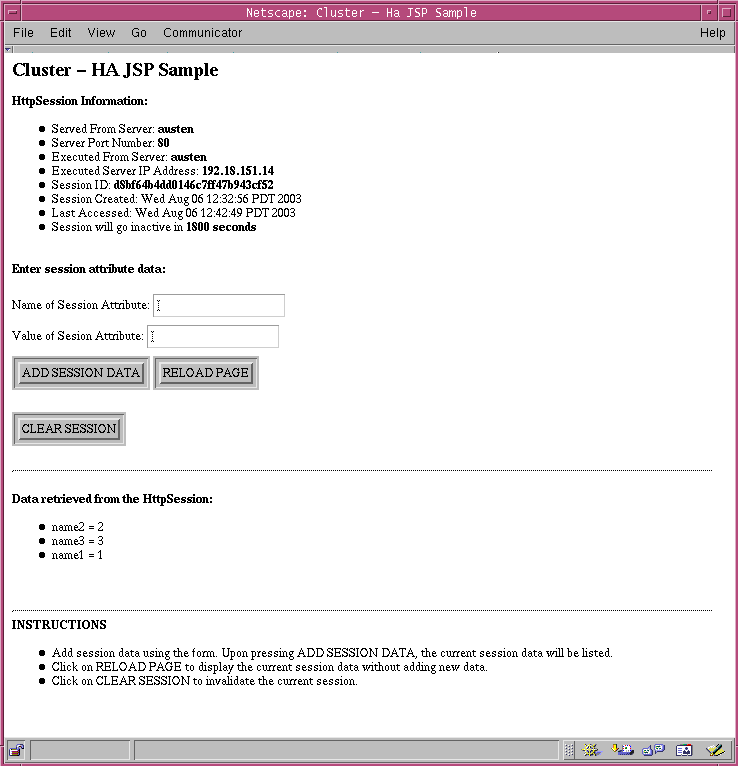

You see the page for this sample application.
Figure 3-4 Cluster JSP Sample Application Page
Your server information is listed at the top of the page, along with a unique Session ID. If you are accessing this application on the application server instance directly, the port information at the top of the page is the application server information. If you are accessing a clustered application through the web server, the port information is the web server information.
- Enter a name and value for the session attribute and click Add Session Data.
Your session data is displayed.
Figure 3-5 Session Data Displayed in Cluster JSP
Notice the Session ID at the top of the page. If you entered the session attributes and clicked ADD SESSION DATA before the session timed out, the Session ID at the top of the page will be the same as the first access.
In the example above, the Session ID d8bf64b4dd0146c7ff47b943cf52 is the same in both cases.

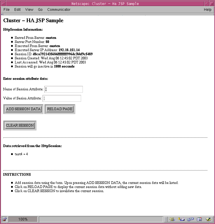

- If you wait until the session times out (1800 seconds) and enter new session attribute data, you see only the latest data you entered, and a new session ID at the top of the page.
You can also simulate a timeout by clicking CLEAR SESSION, which will clear your session data and give you a new session ID.
Figure 3-7 Cluster JSP with New HTTP Session Information
Notice a new Session ID (in this example, d8ca7921435686ffffffff996dc3bbf9c5489) appears at the top of the page and that only the latest information entered (in this example, test4=4) appears in the Data Retrieved from HttpSession section.

- Open two separate browsers and run the application from your web server by typing http://web_server_name:web_server_port/clusterjsp. For example:
http://test.sun.com:80/clusterjsp
Because session data is sticky when you use the load balancer, if you open a browser window and access the application, all reloads or other operations from that browser are considered to be in the same session and will be serviced by a single Sun ONE Application Server instance.
In order to verify that load balancing is working for the application, open a second browser and access the application. Because the session data is stored in cookies, you must either open the second browser on a different machine, or use different browser software on the same machine. Check the Session ID to make sure both browser windows have separate session data.

- To verify that the Sun ONE Application Server instance serviced the request, check the HTTP access logs for each application server instance.
You should see the requests for the clusterjsp application. For more information on checking the access logs, see "Using the Administration Interface to View Logs".

- Open a browser window.
- Access the application from the web server. For example:
- View the web server error log to see which server serviced the request (again, look for RequestExit entries).
- Shut down the Sun ONE Application Server instance that is serving the page.
You can use the Administration interface to shut it down:
- Reload the Cluster JSP sample application page.
The session ID and session attribute data is retained.
- Check the web server error log. Notice that the other Application Server instance is now servicing the request.
Session information should be saved after a server goes offline. The only time you might lose session data during a failure is if the failure occurs while the application is transferring data. In that case, you may see slightly older session data.

- Go to the browser window that displays the HTTP access log for the server that served the initial request. Click OK to refresh the information.
Notice that even though the server is disabled in loadbalancer.xml, it is serving this request.

To see this result, refresh your server instance’s HTTP access log. You should see no new requests.
- Open a third browser window and view the HTTP access log for the other server instance. You should see the Cluster JSP request being serviced by the second server instance.
You can then shut down the application server instance safely.
