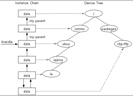

There may also be multiple instances of a single package. For example, a plug-in disk driver may have as many instances as there are disks of that type.

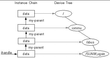

The active package is the package whose methods are currently visible. dev and find-device can be used to change the active package. However, they only make a package's methods visible; they do not enable the execution of those methods.
Before a package's methods may be executed, an instance of the package must be created. Think of an instance as a working copy of the package. An instance contains a working copy of all of the package's private data.
An instance is created from a package by opening that package. The act of opening a package allocates memory for the instance's data and sets the contents of that memory to the initial values stored in the package. The instance exists until it is terminated by closing it. When it is closed, the memory used to hold that instance's private data is freed. Multiple instances may be created from the same package and exist simultaneously.
The current instance is the instance whose private data and methods are available for direct use, that is, directly by name without having to use $call-method.
When a package method accesses a data item, it refers to the copy of that data item associated with the current instance. The private data of the current instance is accessible; the private data of all other instances is inaccessible. Furthermore, to use the methods of a package, an instance of that package must be (at least temporarily) the current instance.
A package to be opened is described by a device path or device alias. The process of opening the package includes opening each of the nodes in the device path from the root to the specified device (from the top of the chain to the bottom). As each of these nodes is opened, an instance is created for the node and all of these instances are linked together in an instance chain as shown in FIGURE 6-1. When a method is accessed using the ihandle of the chain, each node in the chain is able to access the methods of its parent with $call-parent using the links provided by the instance chain.
When the chain is no longer needed, the individual instances of the chain may be closed or the entire chain may be closed. When closing the entire chain, the chain is closed from bottom to top to enable a given node's close method to use parental methods.
The current instance is a dynamic entity. It is changed in several different ways under several different circumstances. Specifically:
This causes any instance data/methods that are subsequently created (prior to the execution of finish-device) to be added to this node, and enables their later execution when an instance of this node is made current.
If a package is in the node /packages, then $open-package can be used to create an instance of the package. Unlike packages opened with open-dev, packages opened with $open-package are opened without opening their ancestors. Each time a package instance is created by $open-package, that instance is attached to the one that called $open-package. FIGURE 6-2 shows the modified instance chain that results when the /iommu/sbus/ledma/le instance opens the obp-tftp support package using $open-package.
Notice that the only additional instance created is one for the obp-tftp package and that this instance is linked to the /iommu/sbus/ledma/le instance. If another instance of obp-tftp were opened by an instance in another instance chain, the resulting instance of obp-tftp would have no association with the instance shown in FIGURE 6-2.
