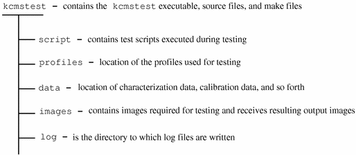

Figure 2-1 shows the required directory structure you need to run test scripts. When you package add the test suite, the kcmstest directory contains the structure shown in the figure.
The kcmstest directory is at the top of the test suite hierarchy in Figure 2-1. It contains the executables necessary to run the test suite.
The initialization file icc.ini in this directory lists the all the default test scripts that are packaged with the test suite. See "Initialization File" for details on the contents of this file.
Four directories shown in Figure 2-1 are of particular significance. These are
script
profiles
data
log
The script directory contains the test scripts to be executed. By default, this directory includes all the test scripts listed in icc.ini. You can run a subset of the scripts, or specify an alternate initialization file when you run the kcmstest command. See "Using kcmstest To Run Test Scripts" for details. If you have written customized versions of scripts to test your CMM, you must install them in this directory.
The profiles directory contains a default set of profiles used with the default test scripts. You can install the profiles used by your CMM into this directory. Note that this is a separate installation from the one you do to make your CMM profiles available to the KCMS framework. For details, see Chapter 6, Putting It All Together.
The data directory contains measurement and calibration data.
The log directory contains output. This directory initially is empty. It holds the results of running test scripts.
The images directory contains images resulting from running the test suite and test TIFF images.
