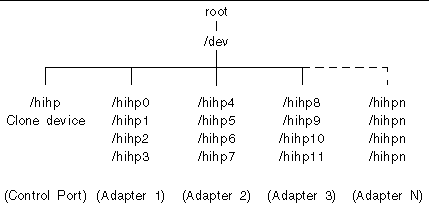

When you have completed the software installation of your software, and the pkgadd utility has run the post-installation script, you will have created the devices illustrated FIGURE 1-1.
