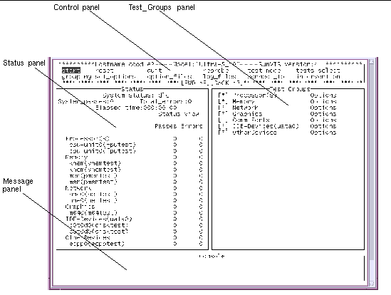

The SunVTS TTY UI is an ASCII based, screen-oriented interface that does not require a graphical window environment. Most of the control and monitoring options that are available in the SunVTS graphical interfaces are also available in the TTY interface.
You can use the TTY interface to run SunVTS from a serial terminal, or through a graphical window tool such as a shell tool, command tool, or CDE terminal window.
The procedures in this section explain how to use the TTY main window:
Use keyboard commands instead of mouse and pointer action to control SunVTS in the TTY UI. The following table lists the keyboard commands and explains how to use them.

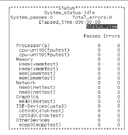

1. Identify the current state of SunVTS in the Status panel.
System_status--provides the following status of SunVTS:

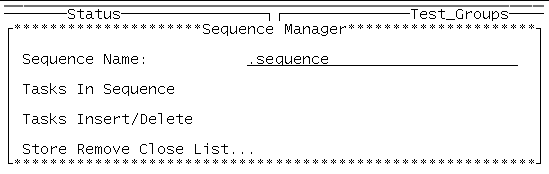

1. Invoke the Sequence Manager menu by selecting the Sequence Manager (FIGURE 5-12) in the DSched Control menu (FIGURE 5-10).
2. Enter the name of the sequence file you want to create in the Sequence Name text field.
By default, the Deterministic Scheduler displays the text field with a .sequence suffix. This filename suffix is not mandatory.
3. Select Task Insert/Delete -> Insert Tasks in the Sequence Manager menu.
4. Select Insert Tasks and press return.
The Tasks Available menu is displayed.
5. Select a task from the list and press return.
This displays a menu with Insert Task as the only choice.
The task you selected is inserted into the sequence.
The order in which you add tasks is the order they will be run in the sequence, with the first added task running first, and the last task running last. However, you can insert tasks into specific places in your list of tasks as described later in this section.
7. Repeat Step 5 and Step 6 to add additional tasks into the sequence.
8. Select Store in the Sequence Manager menu (FIGURE 5-13) and press return.
Your sequence is saved for future use. To run the sequence see To Run the Sequence.
Note - Select Close in the Sequence Manager menu to move back to the DSched Control menu. |

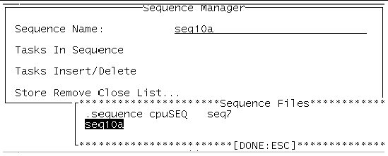

1. Display the Sequence Manager menu (accessed from dsched➤Show DS➤Sequence Manager menu).
2. Select List... in the Sequence Manager menu and press return.
3. Highlight the sequence you want to see, and press return.
If the list is long, use control-F (forward) and control-B (backwards) to scroll through the sequences.
4. You can view the list of tasks available in this sequence by selecting Tasks In Sequence in the Sequence Manager menu.

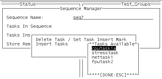

2. Select list... in the Sequence Manager menu and press return.
The list of sequences is displayed.
3. Select the sequence you plan to modify and press return.
4. Select Task Insert / Delete and press return.
The Tasks In Sequence menu is displayed with a list of tasks in the sequence.
5. Select Delete Task/Set Task Insert Mark and press return.
The list of tasks for this sequence is displayed.
6. Select the task you want to delete and press return.
A menu with two choices is displayed.
7. Select Delete Task and press return.
The selected task is deleted from the sequence.
8. Repeat the above steps to remove additional tasks as desired.
9. Use the <Esc> key to move back to the Sequence Manager menu.
10. Save your changes by selecting Store and press return.
11. Select ok and press return.
12. Select Close to exit the Sequence Manager menu.

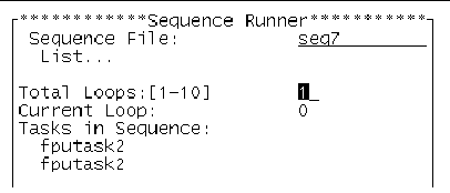

1. Invoke the Sequence Runner menu by selecting Seq Runner in the Start DS menu.
2. Select the sequence that you want to run by selecting List... , highlighting the sequence, and press return.
3. Change the Total Loop value to the number of times you want to repeat the sequence of tests.
Note - The default and minimum number of Total Loops value is 1. You can change the Total Loop value to the desired value, up to a maximum of 10 loops. |
4. Select the Start button at the bottom of the Sequence Runner menu start the sequence.
While testing is underway, you can do any of the following:
Monitor the test progress in the TTY Status panel. All test results are logged in the SunVTS log files.
Suspend and resume the sequence by selecting the Suspend and Resume commands in the Sequence Runner menu.
Close the Sequence Runner menu by selecting the Quit DS UI from the Quit DS menu. Testing will continue, and results will be displayed in the TTY Status panel.
Note - When the Deterministic Scheduler is running, the selection of Show DS displays the Sequence Runner menu. Otherwise, this selection causes the Start DS menu to display. |
