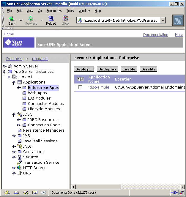

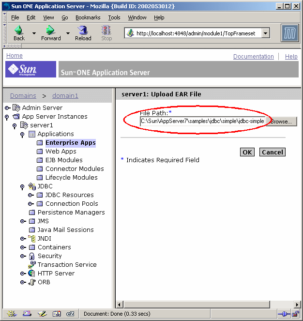

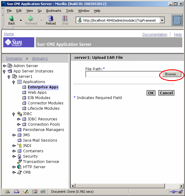

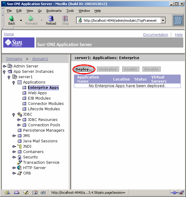

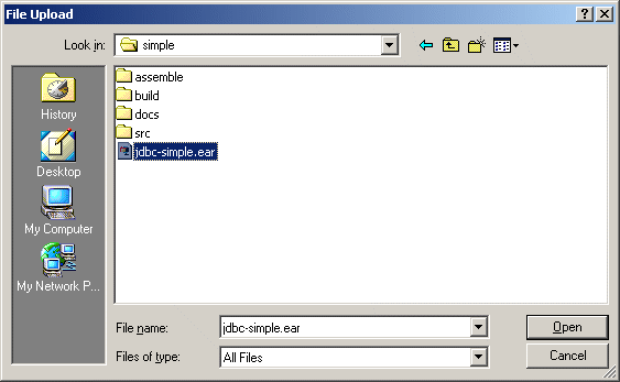

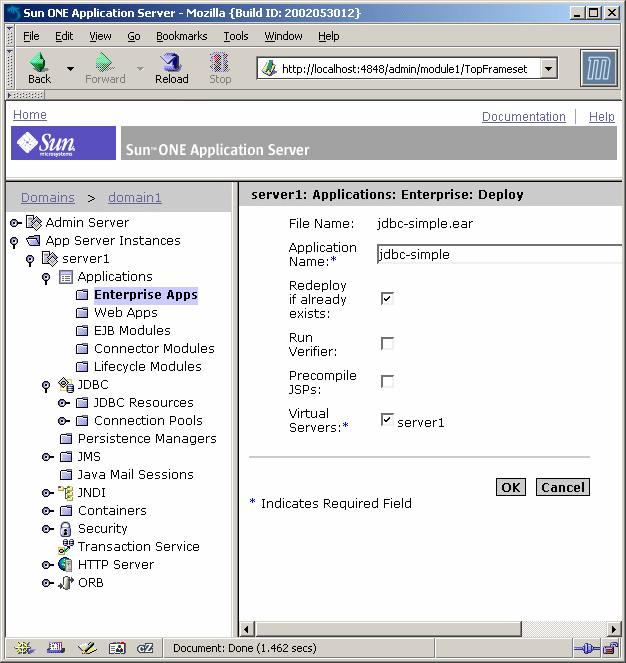

in this directory. Now that you have successfully compiled and assembled the application from scratch, you can use the administrative console to deploy the application. 2. Deploy the Application1. In the administrative console, select and expand the Applications node under the application server instance "server1". 2. Select the folder Enterprise Apps. 3. Click the Deploy... button. 4. Click the Browse... button to bring up the file browser. 5. Navigate to the following directory and select the jdbc-simple.ear file that you just assembled.
6. Click Open to select file. 7. Click OK to proceed to the next step. 8. Before clicking OK to deploy the application, note the Run Verifier and Precompile JSPs check boxes. These options enable you to run a J2EE[tm] application verifier as part of the deployment process. (The verifier can also be access through execution of "asant verify" in the sample applications). The Precompile JPS option enables you to have the JSPs files compiled during the deployment process. Although the deployment process will be longer due to the JSP compilation step, the first access to your JSPs will be much faster. Click OK to deploy the application. 9. Once the deployment process completes, the following page is displayed:
10. Make the application server instance aware of the newly deployed application by applying the changes. 10a. Select the "server1" node. 10b. Click the Apply Changes button. Note that a server instance restart is not required in this case.

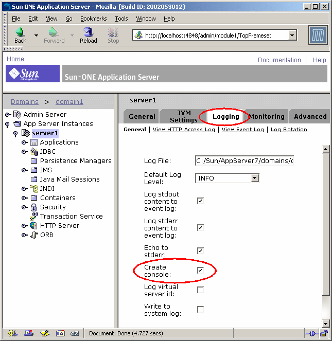

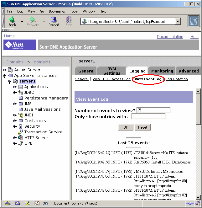

Proceed to Using the Administrative Console to View Event Logs. Viewing Application Output and Logs on Windows While you are testing applications on an application server instance, you will likely find it useful to monitor server event log information on the Windows desktop. Such information can include your application's output to stdout and stderr, exceptions and server event messages. As you observed in the previous section, display of application server instance event log information on the desktop is enabled by default. If you would like to disable display of event log data on the desktop, you can use the administrative console to make this change. The Create Console setting under the Logging->General area of an application server instance enables you to control whether or not the application server log content for that instance is displayed in a command window on the desktop. Using the Administrative Console to View Logs You can also use the administrative console to view server instance log files.
You can refresh the log view by clicking on the OK button. If you would like to see more than 25 log entries, simply enter a larger number in the "Number of errors to view?" area and click OK to refresh the log display. Try a value of 200 or so to see more log entries.
