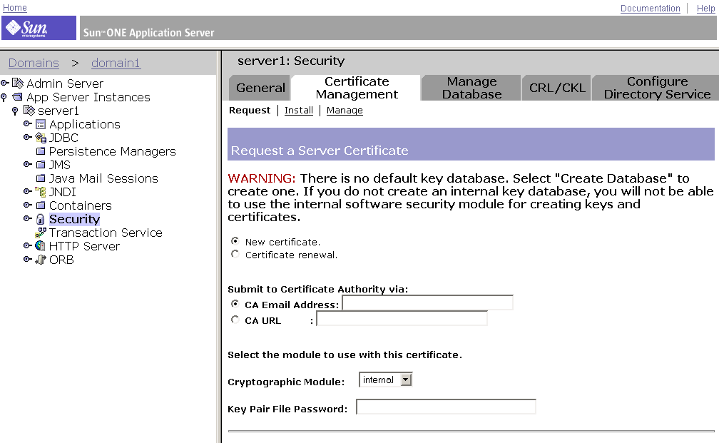

To request a certificate from a CA, perform the following steps in the Administration interface:
- Access App Server Instances and select the server instance in the left pane.
- Access Security.
- Select Certificate Management.
- Click the Request link.
The Request a Server Certificate page is displayed.
   Request a Server Certificate Page
- Select if this is a new certificate or a certificate renewal.
Many certificates expire after a set period of time, such as six months or a year. Some CAs will automatically send you a renewal.
- Perform the following steps to specify how you want to submit the request for the certificate:
If the CA expects to receive the request in an email message, check CA Email and enter the email address of the CA. For a list of CAs, click List of available certificate authorities.
If you are requesting the certificate from an internal CA that is using the Sun ONE Certificate Server, click CA URL and enter the URL for the Certificate Server. This URL should point to the certificate server's program that handles certificate requests.
- Select the cryptographic module for the key-pair file you want to use when requesting the certificate from the drop-down list.
- Enter the password for your key-pair file.
This is the password you specified when you created the trust database, unless you selected a cryptographic module other than the internal module. The server uses the password to get your private key and encrypt a message to the CA. The server then sends both your public key and the encrypted message to the CA. The CA uses the public key to decrypt your message.

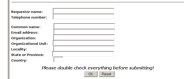

- Enter your identification information.
   Request a Server Certificate Identification Information
The format of this information varies by CA.
- Verify your work to ensure accuracy.
The more accurate the information, the faster your certificate is likely to be approved. If your request is going to a certificate server, you'll be prompted to verify the form information before the request is submitted.

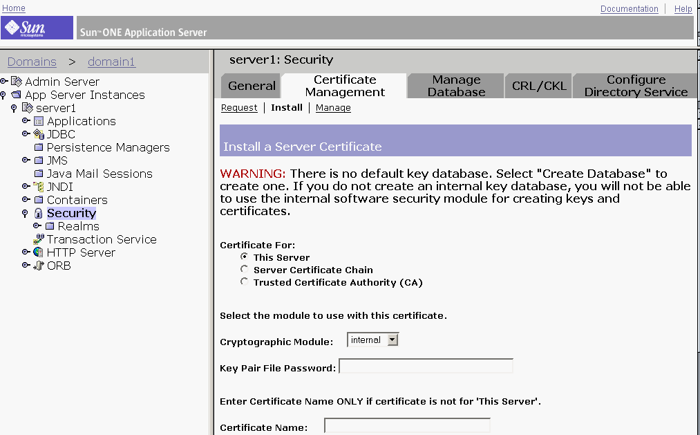

To install a certificate from a CA, perform the following steps in the Administration interface:
- Access Security.
- Click the Install link.
The Install a Server Certificate is displayed.
   Install a Server Certificate Page
- Select the type of certificate you are installing:
This Serverfor a single certificate associated only with your server
Server Certificate Chainfor a CA's certificate to include in a certificate chain
Trusted Certificate Authority (CA)for a certificate of a CA that you want to accept as a trusted CA for client authentication
- Select the cryptographic module from the drop-down list.
- Leave the name for the certificate field blank if it will be the only one used for this server instance, unless:
Multiple certificates will be used for virtual servers. In this case, enter a certificate name unique within the server instance.
Cryptographic modules other than internal are used. In this case, enter a certificate name unique across all server instances within a single cryptographic module.
If a name is entered, it will be displayed in the Manage Certificates list, and should be descriptive. For example, "United States Postal Service CA" is the name of a CA, while "VeriSign Class 2 Primary CA" describes both a CA and the type of certificate.
Note When no certificate name is entered, the default value is applied.
   Certificate Installation Message Information
- Select one:
Message is in this file. In this case, enter the full pathname to the saved email
Message text (with headers). In this case, paste the email text.
If you copy and paste the text, be sure to include the headers "Begin Certificate" and "End Certificate," including the beginning and ending hyphens.
- Click OK.

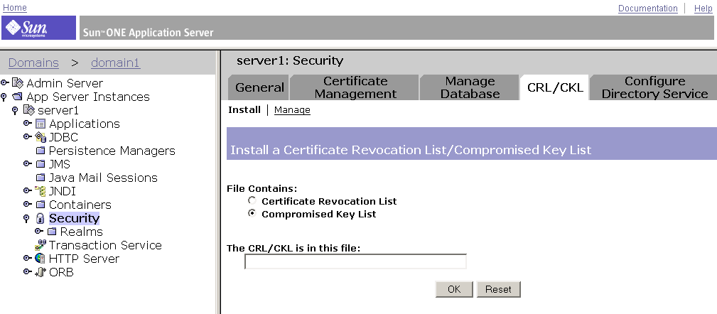

Managing CRLs and CKLs
A certificate revocation list (CRL) and compromised key list (CKL) publishes any certificates and keys that either client users or server users should no longer trust. Typical situations include:
- If data in a certificate changes, for example, a user changes offices or leaves the organization before the certificate expires, the certificate is revoked, and its data appears in a CRL.
- If a key is tampered with or otherwise compromised, the key and its data appear in a CKL.
Both CRLs and CKLs are produced and periodically updated by a CA. As the administrator, you can install new CRLs or CKLs that you obtain from the CA, or delete existing CRLs or CKLs from your system.

Installing a CRL or CKL
To obtain a CRL or CKL from a CA, perform the following steps in the Administration interface:
- Obtain the CA's URL for downloading CRLs or CKLs.
- Enter the URL in your browser to access the site.
- Follow the CA's instructions for downloading the CRL or CKL to a local directory.
- In the Admin interface, access App Server Instances and select the server instance.
- Access Security.
- Select CRL/CKL.
The Install a Certificate Revocation List/Compromised Key List page is displayed.
   Install a Certificate Revocation List/Compromised Key List Page
- Select one:
- Enter the full pathname to the associated file.
- Click OK.
If you selected Certificate Revocation List, the Add Certificate Revocation List page appears listing CRL information.
If you selected Compromised Key List, the Add Compromised Key List page appears listing CKL information.
Note If a CRL or CKL list already exists in the database, a Replace Certificate Revocation List or Replace Compromised Key List page appears. In this case, click Replace.
- Click Add.
- Click OK.
- Access App Server Instances and your server instance in the left pane, then click Apply Changes.
- Stop and start the server for changes to take effect.
