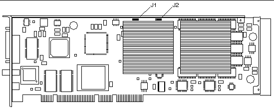

The internal Multiview In and Multiview Out ports on the Expert3D card, shown as J1 and J2 in FIGURE 9-1, are used for cable connections from one Expert3D card to another. These ports are accessible only inside the system chassis.
You can frame lock only two Expert3D cards for multiviewing. When two Expert3D cards are used in a multiviewing configuration, one of the cards is designated as the master and the other as the slave.

3. Connect the frame lock multiview cable to each Expert3D card.
See FIGURE 9-1.
a. Connect the top of the multiview frame lock cable assembly to the Multiview-out J2 connector of the master Expert3D card.
b. Connect the other end of the multiview frame lock cable to the Multiview-in J1 connector of the slave Expert3D card.
