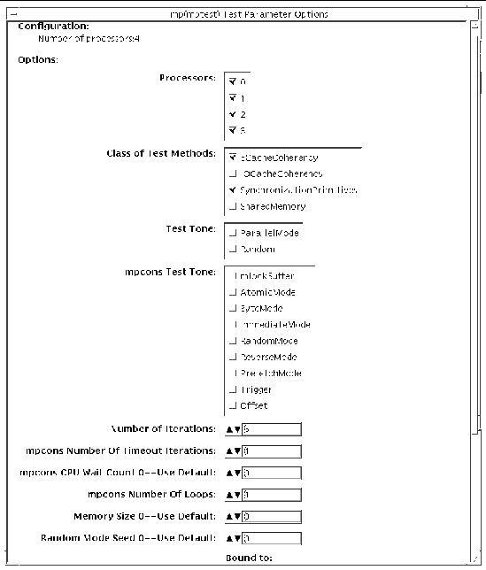

To reach the dialog box below, right-click on the test name in the System Map and select Test Parameter Options. If you do not see this test in the System Map, you might need to expand the collapsed groups, or your system may not include the device appropriate to this test. Refer to the SunVTS User's Guide for more details.
FIGURE 7-1 mptest Test Parameter Options Dialog Box
The processors that can be tested are listed in the Configuration area of the menu. You can enable or disable the multiprocessing test for individual processors on this menu.
The options listed in can be run alone or concurrently with other options.
TABLE 7-1 mptest Options
mptest Options
Description
Processors
This option can be used to select the CPU IDs for which to run this test. The test will use all CPUs on the system by default. Hence, this parameter is optional.
The CPU IDs currently present in the system can be retrieved with the psrinfo(1M) command.Specifying a CPU ID not present in the system or one which is currently offline induces an appropriate error message from the test.
Class of Test Methods
The Multiprocessor (MP) functionality consists of different components. A class of test method is used to specify the functionality of the MP system to be tested. Currently, the Class-of-Test methods supported by mptest are: E-CacheCoherency, IOCacheCoherency, SynchronizationPrimitives, and SharedMemory.This option can be used to selectively test one or more of the MP functions. If you do not specify the class of test methods, E-CacheConsistency and SynchronizationPrimitives are selected by default.
Test Tone
A test tone is a different way of executing the same test. Selecting a different test tone will exercise and test the MP functionality in a slightly different manner. The tone option can be used to select the test tone for the test. The supported test tones are: Random and Parallel mode. The "Random" test tone introduces some randomness in testing. The "ParallelTone" implies that the tests perform parallel operations (like write) on different CPUs at the same time. This tone option is optional.If you do not specify any option, then the test assumes a normal tone of testing.
mpcons Test Tone
This option is used to select the tone for mpconstest cases in the mptest. These are options directly from the mpconstest.The descriptions from the mpconstest options are as follows:mlockBuffer - Lock the shared buffer in memoryAtomicMode - Enable Atomic modeByteMode - Enable Byte modeImmediateMode - Enable Immediate modeRandomMode - Enable Random ModeReverseMode - Reverse direction to decrement through memoryPrefetchMode - Enable use of V9 prefetch instructionsTrigger - Enable LA trigger on errorOffset - Enable use of linesize buffer offsets
This option is not mandatory. By default, the mpcons_tone assumes a normal mode of operation.
Number of Iterations
Same option as in mpcontest. This option is used to select the number of iterations for running the test loops. The range for this option is 1 to 200 and the default is 5.
Number Of Timeout Iterations
Same option as in mpcontest. Selects number of timeout iterations.
CPU Wait Count 0
Same option as in mpcontest. Forces CPU 1 to write first if number of CPUs is less than count.
Number of Loops
Same option as in mpcontest. Sets loops to specified value.
Memory Size 0--Use Default
Same option as in mpcontest. Specifies memory size (MB). This should always be set to the default value.
Random Mode Seed 0
Same option as in mpcontest. Sets random number seed to specified value.
