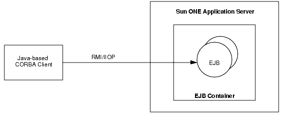

Stand-alone Scenario
In the simplest case, a stand-alone program which does not use the ACC, running on a variety of operating systems uses IIOP to access business logic housed in backend EJB components, as shown in the figure "Stand-alone Client Accessing the EJB Components".
Figure 3-1 Stand-alone Client Accessing the EJB Components

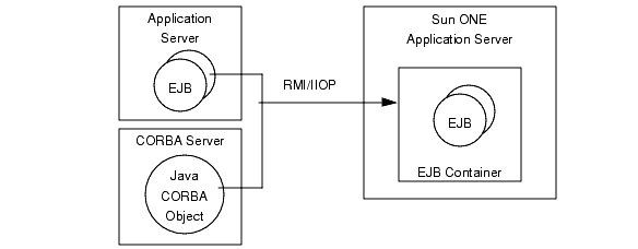

Server to Server Scenario
CORBA objects, and other application servers can use IIOP to access EJB components housed in Sun ONE Application Server, as shown in the figure "Application Server and CORBA Objects Accessing EJB Components".
Figure 3-2 Application Server and CORBA Objects Accessing EJB Components

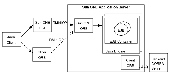

ORB Support Architecture
CORBA client support in Sun ONE Application Server involves the communication between the ORB on the client and the ORB on the server, as shown in the figure "ORB Support Architecture".
Figure 3-3 ORB Support Architecture
You can use the ORB that is bundled as part of the Sun ONE Application Server, or you can use a third-party ORB (ORBIX 2000 or ORBacus 4.1).
