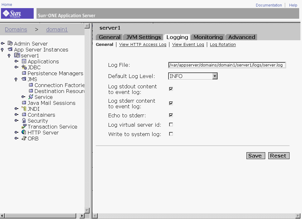

Default Logging in server.log
On both the UNIX and Windows platforms, the log files are created in server.log located in the log sub-directory. Logs coming from all the server components and virtual servers of an instance are collected in this single file.
The default log level for the entire server can be set. However, you can also override the default log level for a particular subsystem at the subsystem level. You can also redirect stdout and stderr to the server's event log and direct the log output to the operating system's system log. Additionally, you can direct stdout and stderr content to the server’s event log. Log messages by default are sent to stderr in addition to the specified server log file.
Another feature available is to log the virtual server ID with the log message. This is a useful feature when multiple virtual servers are used to log messages to the same log file. You can choose to write the log messages to system log. When you do so, logging is not performed on the server.log file. Instead the syslog logging service on UNIX, or the system logging service on Windows platform is used to produce and manage logs.
You can also use the server.xml attributes to control the contents of this file. For details about the server.xml file, see the Sun ONE Application Server Administrator’s Configuration File Reference.

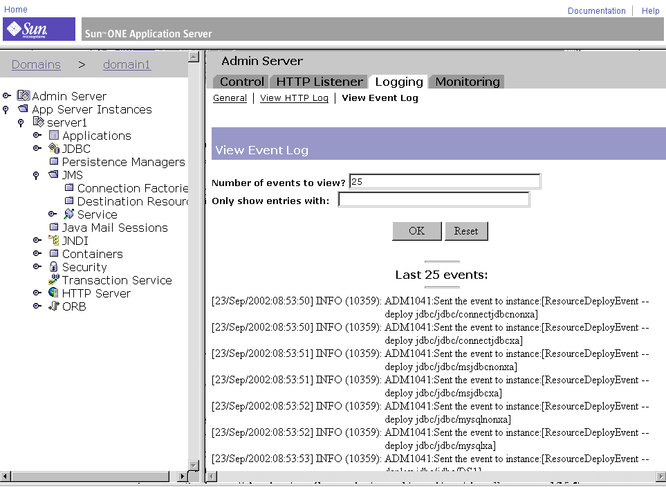

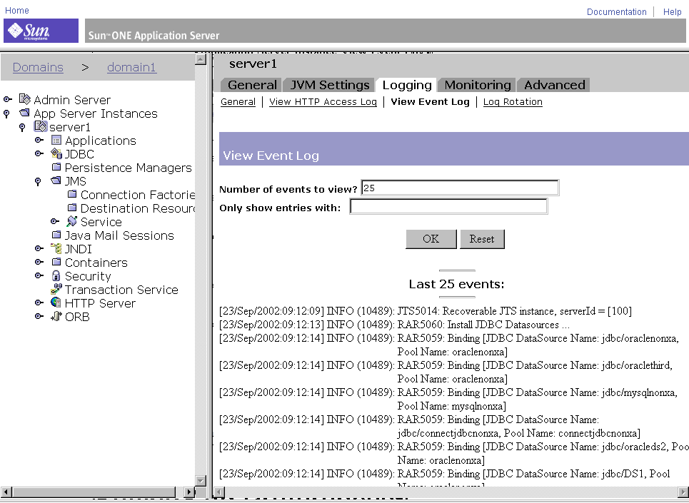

Logging Using the Windows eventlog
For more information on the event log mechanism used in the Windows operating environment, refer to the Windows help system index for the keywords Event Logging.

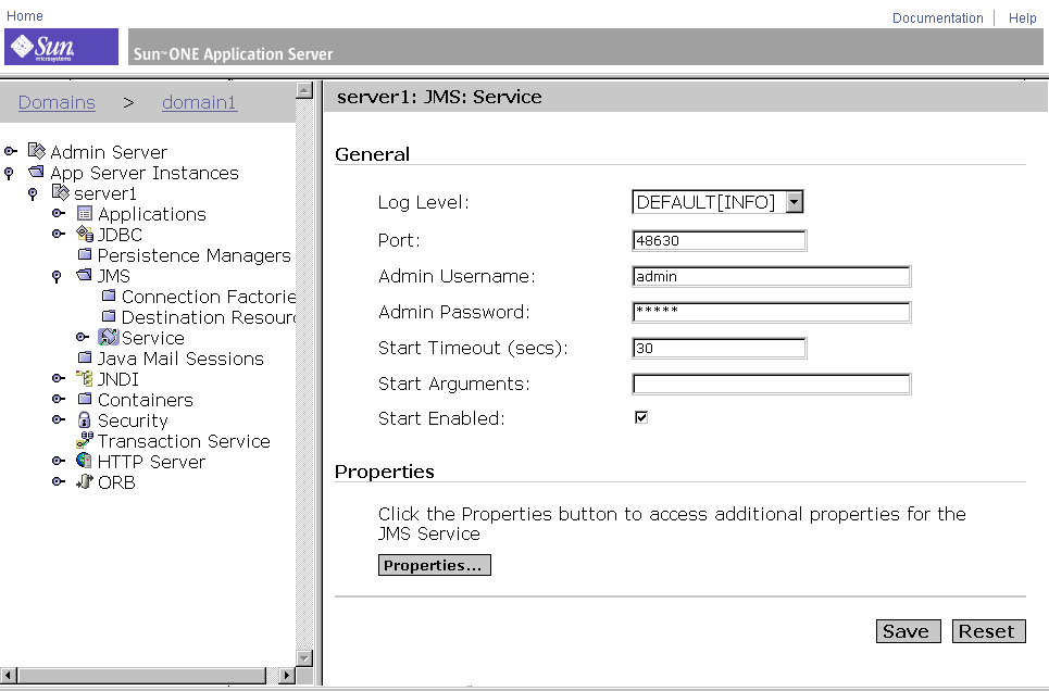

You can assign a log level for each Sun ONE Application Server subsystem for which logging is enabled. A log level is useful to streamline the amount of message information that is recorded during runtime. The level is specified in the server.xml file for the intended subsystem. You can specify the log level from the Administration interface for the selected subsystem, or, you can edit the server.xml file directly to set the desired log level for the selected subsystem.
An example of setting the log level through the Administration interface is shown in the figure "Log Level for JMS Service". To set the log level for each subsystem or component directly in the server.xml file, see the Sun ONE Application Server Administrator’s Configuration File Reference.

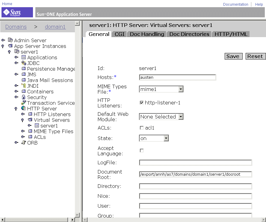

About Virtual Servers and LoggingThe Sun ONE Application Server can have virtual server instances. Each virtual server within a Sun ONE Application Server instance has its own identity and may have its own log file. The use of separate log files for each virtual server can help track server activity for particular transactions and resources.
To specify the log file name for a virtual server from the Administration interface, go to the HTTP Server link from the directory tree and open the server instance element under the virtual server folder to display the General tab on the right frame. You can enter the path and name of the log file for this virtual server in the Log File field. The figure "Setting the Virtual Server Log File Name" shows where this setting is located.
Note
When logging is enabled and an application is running, logged messages from the application are logged without the virtual server ID.
Figure 5-1 Setting the Virtual Server Log File Name
You can also direct logged messages from multiple virtual servers to one server log file. When so doing, you may wish to enable the log-virtual-server-id in the log service element of the server.xml file. This helps users to distinguish log messages originating from different virtual servers.

Figure 5-2 Log Level for JMS Service
Note
On the Windows platform, if you choose to send logs to the Windows server.log, only messages with level INFO, WARNING, SEVERE, ALERT or FATAL are logged to Windows Event Log.
The table "Log Levels" defines the log levels, in increasing order of severity, provided for messages in Sun ONE Application Server. These log levels match the requirements of the JDK1.4 logging API specification. In addition, the log levels ALERT and FATAL are specific to Sun ONE Application Server and are not supported in the JDK1.4 logging API.

Configuring the Log Service
The log service is an element within the J2EE Service Element category in the server.xml file, as described in the Sun ONE Application Server Configuration File Reference. The log service is used to configure the system logging service, which includes the following log files:
Configuration of the system logging service includes specifying values for attributes of the log service element.
Figure 5-3 Log Service Administration for the Service Instance
You can configure the following attributes for the log service element through the Administration interface, as shown in the figure "Log Service Administration for the Service Instance".
The Log Service link is accessible from the expanded tree hierarchy for the server instance in the left pane of the Administration interface. The following table describes each of the attributes that can be configured, along with the default and range of values allowed.
Table 5-5 Log Service Attributes
Attribute
Default
Description
file
server.log1
(optional) Overrides the name or location of the server log. The file and directory in which the server log is kept must be writable by whatever user account used to run the server.
level
INFO
(optional) Controls the default type of messages logged by other elements to the server log. Allowed values are as follows, from highest to lowest: FINEST, FINER, FINE, CONFIG, INFO, WARNING, SEVERE, ALERT, FATAL.
Each value logs all messages for all lower values; for example, FINEST logs all messages, and FATAL logs only FATAL messages. The default value is INFO, which logs all INFO, WARNING, SEVERE, ALERT, and FATAL messages.
log-stdout
True
(optional) If true, redirects stdout output to the server log. Legal values are on, off, yes, no, 1, 0, true, false.
log-stderr
True
(optional) If true, redirects stderr output to the server log. Legal values are on, off, yes, no, 1, 0, true, false.
echo-log-messages-to-stderr
True
(optional) If true, sends log messages to stderr in addition to the server log. Legal values are on, off, yes, no, 1, 0, true, false.
create-console
False
(optional) If true, creates a console window on Windows operating system for stderr output. Legal values are on, off, yes, no, 1, 0, true, false.
False
(optional) If true, virtual server IDs are displayed in the virtual server logs. These are useful if multiple virtual-server elements share the same log file.
use-system-log
False
If true, uses the UNIX syslog service or Windows Event Logging to produce and manage logs.
1In the directory specified by the log-root attribute of the server element.

To Specify a Log Level
To specify a log level for ORB, Web Container, EJB Container, MDB Container (within the EJB Container), Java Transaction Service, and JMS Service, perform the following procedure:
- In the left pane of the Administration interface, expand the Sun ONE Application Server instance to display the components and subsystems you wish to edit.
- Click the link for the desired component or subsystem.
- In the right page of the Administration interface, select one of the following log level parameters, from the Log Level drop-down list. The log levels are described in "About Log Levels".
To Specify a Log File: (Virtual Server)
To specify a log file, perform the following procedure:
- In the left pane of the Administration interface, expand the Sun ONE Application Server instance to display the HTTP Server subsystem.
- Click the HTTP Server link.
- Click the Virtual Server link.
- Click the desired server instance link.
- In the right page of the Administration interface, under the General tab, enter the desired directory path and file name for the Log File field.

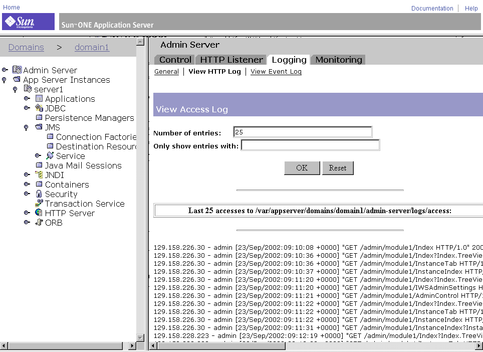

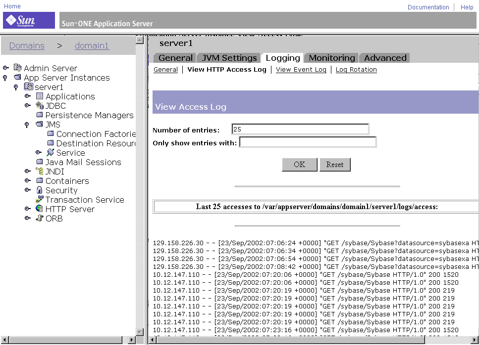

Viewing the Access Log FileYou can view both the Administrator server’s and the Sun ONE Application Server instance’s http log files.
To view the Administration Server’s http log, select the Admin Server from the left pane in the Administration interface, and then choose the Logging tab from the right page. The View HTTP Access Log link is displayed. Select this link to view the configured access log. An example of the displayed log is shown in the figure "Admin Server View HTTP Access Log".
Figure 5-4 Admin Server View HTTP Access Log
To view an access log for the application server instance, click the server instance desired from the left pane of the Administration interface. Click on the Logging tab from the right pane. Click the View Access Log link to display the configured active access log for that server instance. An example is shown in the figure "Application Server Instance View Access Log".
Figure 5-5 Application Server Instance View Access Log
Viewing the Event Log FileYou can view both the Administrator server’s and the Sun ONE Application Server instance’s active event log files.
To view the Administrator server’s event log, select the Admin Server from the left pane, and then choose the Logging tab from the right page. The View Event Log link will be displayed. Select this link to view the configured event log. An example of the displayed log is shown in the figure "Admin Server View Event Log".
Figure 5-6 Admin Server View Event Log
To view the event log for the application server instance, click the server instance desired from the left pane of the Administration interface, and then choose the Logging tab from the right pane. The View Event Log link will be displayed. Select this link to view the configured event log. An example of the displayed log is shown in the figure "Application Server Instance View Event Log".
Figure 5-7 Application Server Instance View Event Log

- Choose Find from the View menu to search for one of these labels in the log. Choose Refresh from the View menu to see updated log entries.
For more information about the Event Viewer, consult your system documentation.
