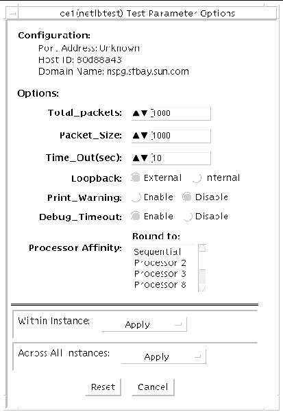

To reach the dialog box below, right-click on the test name in the System Map and select Test Parameter Options. If you do not see this test in the System Map, you might need to expand the collapsed groups, or your system may not include the device appropriate to this test. Refer to the SunVTS User's Guide for more details.
Refer to for test parameter descriptions.
Runs the full set of subtests. It is assumed that the host is not connected to the network through the intended test device(s). |
Since netlbtest requires a loopback connector, it can only be selected when Intervention mode is enabled.
/opt/SUNWvts/bin/netlbtest standard_arguments -o dev=device, tpkts=n, pksz=pkt_size, lb=Internal, warn=Disable, timeout=number_of_seconds
