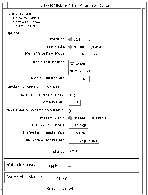

disktest Test Options
To reach the dialog box below, right-click on the test name in the System Map and select Test Parameter Options. If you do not see this test in the System Map, you might need to expand the collapsed groups, or your system may not include the device appropriate to this test. Refer to the SunVTS User's Guide for more details.
Screenshot of the disktest Test Parameter Options dialog box.
FIGURE 8-1 disktest Test Parameter Options Dialog Box
The following table describes the disktest option menu for different test modes.
TABLE 8-2 disktest Configurations and Options
disktest Options
Description
Partition
Displays the partition for the Media subtest. If a partition is mounted, its mount point is appended after the partition number, such as 1(/usr), where 1 is the partition number, and "(/usr)" is the mount point.
Test Media
Enable or Disable the media subtest.
Media Write Read Mode
Selects Read-Only or Compare after Read or Read after Write.
Media Test Method
Selects the Media Test Methods (SyncIO and AsyncIO).
Media Coverage (% TB, GB, MB, KB, B)
Enables users to test all or part of a partition (in percentage or in any of TB, GB, MB, KB, B units)
Raw Test Pattern (P0 to P16)
Enables user to specify the write, read pattern.
- P0 - Low Frequency Pattern
- P1 - Low Transition Density Pattern
- P2 - High Transition Density Pattern
- P3 - Compliant Jitter Pattern
- P4 - Compliant Jitter: RPAT
- P5 - Compliant Jitter: CRPAT
- P6 - Compliant Jitter: JTPAT
- P7 - Compliant Jitter: CJTPAT
- P8 - Compliant Jitter: SPAT
- P9 - Compliant Jitter: CSPAT
- P10 - 8 Bit Cable Pattern
- P11 - 16 Bit Cable Pattern
- P12 - 8 Bit Xtalk Pattern
- P13 - 16 Bit Xtalk Pattern
- P14 - MFM Pattern
- P15 - Generic Test Patterns
- P16 - SATA Test Patterns
Seek Pattern
Enables specifying the pattern of the disk head movement.
- S - Sequential
- SR - Sequential Reverse
- LS - Low Power Sequential
- R - Random
- LB - Low Power Butterfly
- LR - Low Power Reverse Butterfly
- AB - Actuator Butterfly
- AR - Actuator Reverse Butterfly
Seek Point (%, I, O, M, TB, GB, MB, KB, B)
Enables specifying the seek point offset for the I/O. You can specify the offset in percentage or any of TB, GB, MB, KB, B or and I, M, O; that is, Initial, Middle), Outer.
Media Transfer Size
Displays the transfer size of the media subtest.
Test File System
Selects the File System subtest.
File System File Size
Specifies the size for each of the two temporary files for File System testing.
File System Transfer Size
Displays the transfer size of the File System subtest.
File System Test Pattern
Test pattern of File System subtest.
Connection Test for Hard Disk
- Option Menu for hard disk partition--0 - 7 [default]
- Test Media--[Enable] (fixed to Enable)
- Media Write Read Mode--[Read Only] (fixed to Read Only)
- Media Test Method-[SyncIO] (fixed to SyncIO)
- Media Coverage(%)--1
- Media Transfer Size--[2 KB]
- Test File System--[Disable] (fixed to Disable)
Online Mode for Hard Disk
- Partition--0 - 7 [default]
- Test Media--[Enable] [Disable]
- Test Mode--[Read-only~] (fixed to Read-only)
- Media Coverage (% TB GB MB KB B)--[10~] (fixed to 10%)
- Media Transfer Size--[2KB~] (fixed to 2 KB)
- Test File System--[Disable~] (fixed to Disable)
- Media Test Method--[SyncIO] [AsyncIO]
- Raw Test Pattern--[P15~] (fixed to P15)
- Seek Pattern--[S~] (fixed to S)
- Seek Point (% TB GB MB KB B)--[I~] (fixed to I)
Functional Test for Hard Disk
- Media Write Read Mode--[Readonly] [CompareRead] [WriteRead]
- Media Test method--[SyncIO] [AsyncIO]
- Media Coverage (% TB, GB, MB, KB, B)
- Raw Test Pattern (P0 to P16)
- Media Transfer Size--[2KB] [16KB] [32KB] [64KB] [128KB] [256KB] [512KB]
- Test File System--[Enable] [Disable]
- File System File Size--[512KB] [2MB] [8MB] [20MB] [100MB] [200MB]
- File System Transfer Size--[512B] [1024B] [10KB] [40KB] [80KB]
- File System Test Pattern--[sequential] [0x00000000] [0xffffffff] [0x5aa55aa5] [0xdb6db6db] [random]
- Seek Pattern --[S~] (fixed to S)
Functional Test for Floppy Disk
- (under Other-Devices group)--partition: 0 - 7 [default]
- Media Write Read Mode--[Read-only] [BackupWriteRead]
- Media Transfer Size--[2KB] [10KB] [20KB]
- Floppy File Size-- [100KB] [200KB]
- Floppy Transfer Size--[512B] [1024B] [10KB]

The following example shows how to run disktest on a partition "0" (which is mounted under "/") for the disk device c0t0d0. The media subtest is enabled in ReadOnly mode using SyncIO method. The coverage specified is 30% with 512 KB transfer size. The File System subtest is disabled.
# /opt/SUNWvts/bin/disktest -f -o partition=0"(/)", rawsub=Enable, rawrw=ReadOnly, method=SyncIO, rawcover=30, rawiosize=512KB, fssub=Disable, dev=c0t0d0
