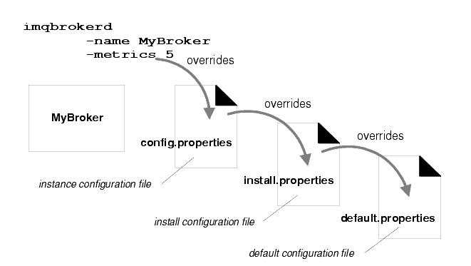

Merging Property Values
At startup, the system merges property values in the different configuration files. It uses values set in the installation and instance configuration files to override values specified in the default configuration file. You can override the resulting values by using imqbrokerd command options. This scheme is illustrated in Figure 5-1.
Figure 5-1    Broker Configuration Files

- Change or add Logger properties in the config.properties file for a broker before you start the broker.
- Specify Logger command line options in the imqbrokerd command that starts the broker. You can also use the broker option -D to change Logger properties (or any broker property).
Options passed on the command line override properties specified in the broker instance configuration files. Table 5-4 lists the imqbrokerd options that affect logging.
