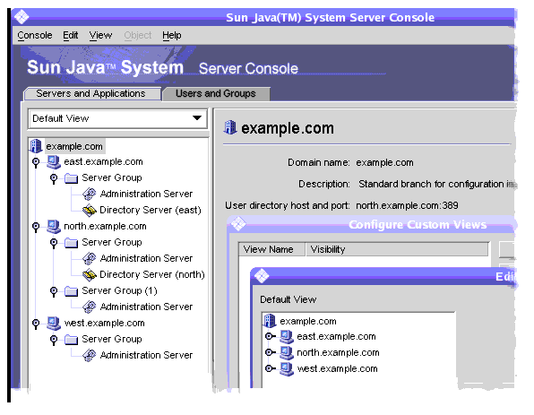

Server Console is a stand-alone Java application that works in conjunction with an instance of Directory Server and an instance of Administration Server. It acts as the front-end management application for Sun Java System software. It finds all servers and applications registered in your configuration directory, displays them in a graphical interface, and lets you manage and configure them. In addition, Server Console provides graphical tools for locating and managing entries in the user directory. Figure 1-1 shows the Server Console interface.
Figure 1-1 The Sun Java System Server Console Interface

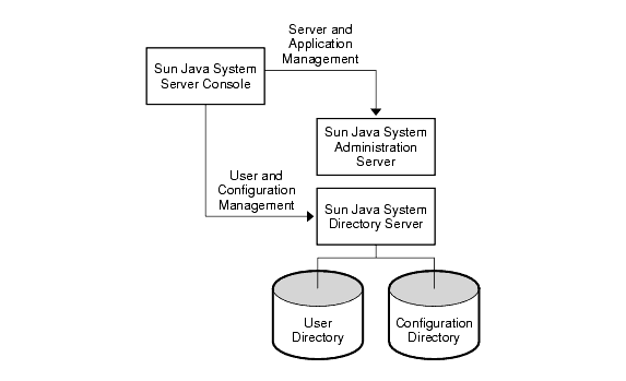

Server Console lets you manage resources (servers or applications) as well as add or edit user information. When you use Server Console to manage resources, the Console sends HTTP requests to the instance of Administration Server that controls the resource. Upon receiving these requests, the instance of Administration Server executes programs that perform the requested tasks. For example, Server Console can execute programs to modify the server and application settings that are stored in the configuration directory or to change the port number that a server listens to.
When you use Server Console to add or edit user entries, it sends Lightweight Directory Access Protocol (LDAP) messages directly to Directory Server. The information in these messages is then stored in the user directory. Figure 1-2 illustrates the system.
Figure 1-2 Simple System With Sun Java System Server Console

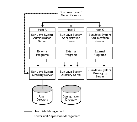

Figure 1-2 shows an example of a relatively simple system. As your enterprise grows and your needs change, you have the flexibility to add additional hosts and servers. Even when you install new hardware and software, you can continue to use a single instance of Server Console to manage your network. Figure 1-3 shows how a more complex system might be organized.
Figure 1-3 More Complex System With Sun Java System Server Console
