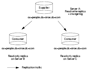

Single-Master Replication
In the most basic replication configuration, a supplier server copies a replica directly to one or more consumer servers. In this configuration, all directory modifications occur on the read-write replica on the supplier server, and the consumer servers contain read-only replicas of the data.The supplier server must perform all modifications to the read-write replicas stored on the consumer servers. Figure 6-1 shows this simple configuration.
Figure 6-1    Single-Master Replication
The supplier server can replicate a read-write replica to several consumer servers. The total number of consumer servers that a single supplier server can manage depends on the speed of your networks and the total number of entries that are modified on a daily basis. However, you can reasonably expect a supplier server to maintain several consumer servers.

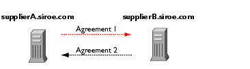

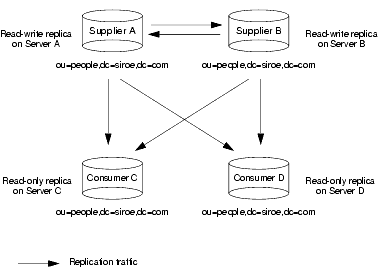

Multi-Master Replication
In a multi-master replication environment, master copies of the same information can exist on two servers. This means that data can be updated simultaneously in two different locations. The changes that occur on each server are replicated to the other. This means that each server plays both roles of supplier and consumer.When the same data is modified on both servers, there is a conflict resolution procedure to determine which change is kept. The Directory Server considers the valid change to be the most recent one.
Although two separate servers can have master copies of the same data, within the scope of a single replication agreement, there is only one supplier server and one consumer. So, to create a multi-master environment between two supplier servers that share responsibility for the same data, you need to create more than one replication agreement.The following figure shows this configuration:
Figure 6-2    Multi-Master Replication Configuration (Two Masters)
In this illustration, Supplier A and Supplier B each hold a read-write replica of the same data.
The number of masters or suppliers you can have in any replication environment is limited to two. However, the number of consumer servers that hold read-only replicas is not limited. Figure 6-3 shows the replication traffic in an environment with two masters (read-write replicas in the illustration), and two consumers (read-only replicas in the illustration). This figure shows that the consumers can be updated by both masters. The master servers ensure that the changes do not collide.
Figure 6-3    Replication Traffic in a Multi-Master Environment

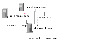

Cascading Replication
In a cascading replication scenario, a hub supplier receives updates from a supplier server, and replays those updates on consumer servers. The hub supplier is a hybrid: it holds a read-only replica, like a typical consumer server and it maintains a change log like a typical supplier server.Hub suppliers do not actually keep copies of the master data themselves, they only pass it on as it received it from the original master. For the same reason, when a hub supplier receives an update request from a directory client, it refers the client to the master server.
Cascading replication is useful, for example, if some network connections between various locations in your organization are better than others. For example, suppose the master copy of your directory data is in Minneapolis, and you have consumer servers in Saint Cloud as well as Duluth. Suppose, too, that your network connection between Minneapolis and Saint Cloud is very good, but your network connection between Minneapolis and Duluth is of poor quality. Then, if your network between Saint Cloud and Duluth is of acceptable quality, you can use cascaded replication to move directory data from Minneapolis to Saint Cloud to Duluth.
This cascading replication scenario is illustrated as follows:
Figure 6-4    Cascading Replication Scenario

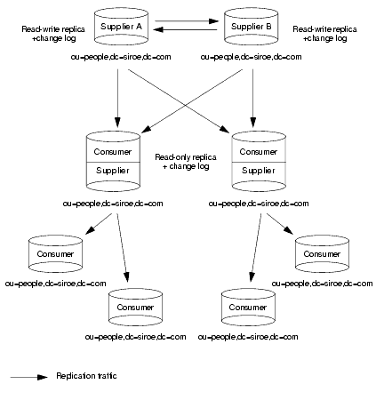

The same scenario is illustrated below from a different perspective. It shows how the replicas are configured on each server (read-write or read-only) and which servers maintain a change log.
Figure 6-5    Replication Traffic and Change logs in Cascading Replication

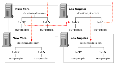

Mixed Environments
You can combine any of the scenarios outlined in the previous sections to best fit your needs. For example, you could combine a multi-master configuration with a cascading configuration to produce something similar to the scenario illustrated in Figure 6-6.
Figure 6-6    Combined Multi-Master and Cascading Replication

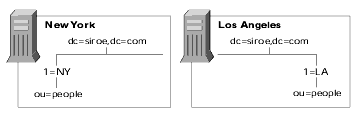

Example of Network Load Balancing
Suppose your enterprise has offices in two cities. Each office has specific subtrees that they manage as follows:
Each office contains a high-speed network, but you are using a dial-up connection to network between the two cities. To balance your network load:
Select one server in each office to be the master server for the locally managed data.
Replicate the directory tree on each master server (including data supplied from the remote office) to at least one local Directory Server to ensure availability of the directory data. You can use multi-master replication for the suffix managed locally, and cascading replication for the suffix that is receives a master copy of the data from a remote server.
- Replicate locally managed data from that server to the corresponding master server in the remote office.

Replication and Database Links
When you distribute entries using chaining, the server containing the database link points to a remote server that contains the actual data. In this environment, you cannot replicate the database link itself. You can, however, replicate the database that contains the actual data on the remote server.You must not use the replication process as a backup for database links. You must backup database links manually. For more information about chaining and entry distribution, refer to Chapter 5, "Designing the Directory Topology".
Figure 6-7    Replicating Chained Databases
