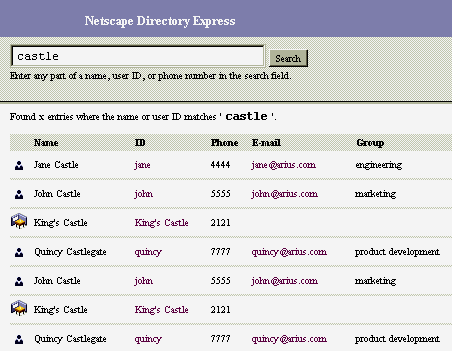

Directory Express (pb.conf)
Directory Express is a basic directory lookup tool that can be used out of the box.
Table 1-1    Directory Express Search Result

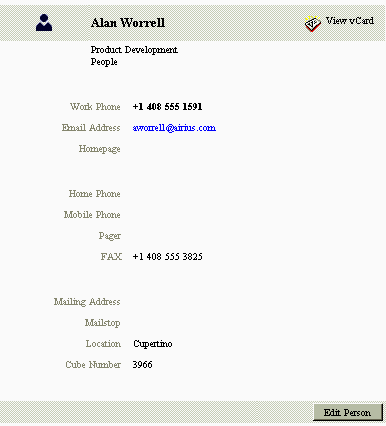

Table 1-2    Directory Express Extended Search Results

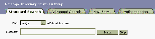

Default Gateway (dsgw.conf)
In addition to the standard search form, the default gateway provides an advanced search form, a directory server authentication form, and a form for adding and modifying entries.
Table 1-3    Default Gateway
